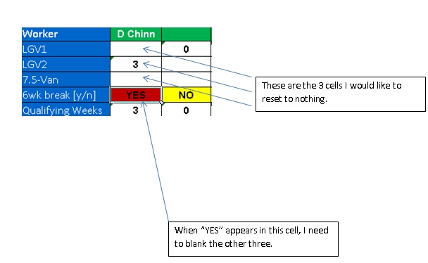

    • #1304381
      Hi Steve, thanks very much indeed for the rapid response, I have inserted this picture so you can see what I am trying to do.
      29263-Spreadsheet
      I really do not now which one to use, how do I insert this macro? Perhaps there may be an easier way?
      Once again, thanks very much for having a look at this for me.
      Steve – Southampton UK

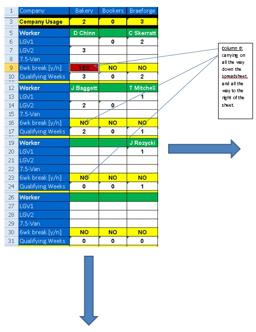

    • #1304443
      Hi again gentlemen,
      okay, the exact cells in question are ALWAYS, B9 (this is where the YES is) and the deletion OR blanking is the 3 cells above it, however this is required to work on the right, literally as far right as I require it to go. See attached basic illustration.
      29273-Spreadsheet
    • #1304458
      Try this code. It checks to see that the column is > 1 (col A=1) and that the row is one of every 7th row starting at 9 (Rows 9, 16, 23, 30, etc). If one of those cells changes, and the value is yes (the ucase ensures the case is irrelevant) it clears the 3 rows above it in the column.
      Steve
      Code:
      Option Explicit
      Private Sub Worksheet_Change(ByVal Target As Range)
        Dim rCell As Range
        Dim lRow As Long
        Dim iCol As Integer
        Dim x As Long
        For Each rCell In Target
          iCol = rCell.Column
          lRow = rCell.Row
          If iCol > 1 And (lRow - 9) Mod 7 = 0 Then
            If UCase(Cells(lRow, iCol)) = "YES" Then
              Application.EnableEvents = False
              Range(Cells(lRow - 1, iCol), Cells(lRow - 3, iCol)).ClearContents
              Application.EnableEvents = True
            End If
          End If
        Next
      End Sub
