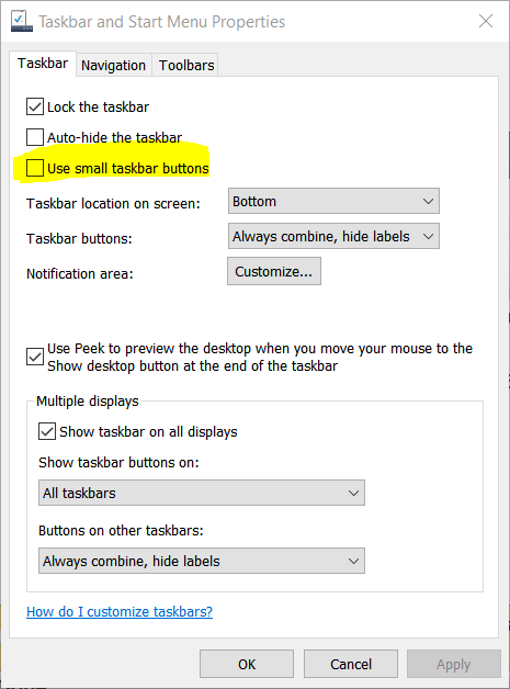

      I think you’ll have more success with:
      Control Panel ->All Control Panel Items ->Personalization -> Taskbar and Navigation (lower left corner).

      RG,
      That part of the control panel has been moved to settings in the latest Insider Preview Builds and therefore in the Anniversary update due in July. If the OP can use that part of the Control Panel now great but it won’t be available much longer.
    • #1567390
      Thanks guys, but I already have that turned off and I would still like to have them bigger. I was wondering if there is a Registry setting that can be changed to make that happen. I don’t know, I just have the questions. 🙂
