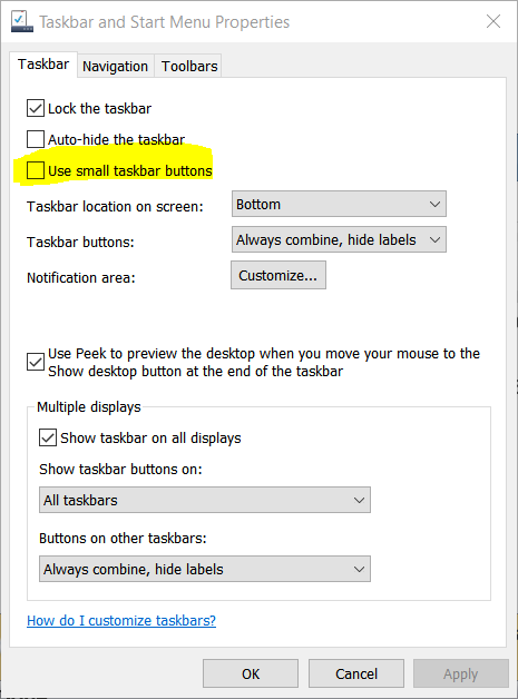

      I think you’ll have more success with:
      Control Panel ->All Control Panel Items ->Personalization -> Taskbar and Navigation (lower left corner).
      44739-TBProperties

      Thanks guys, but I already have that turned off and I would still like to have them bigger. I was wondering if there is a Registry setting that can be changed to make that happen. I don’t know, I just have the questions. 🙂
