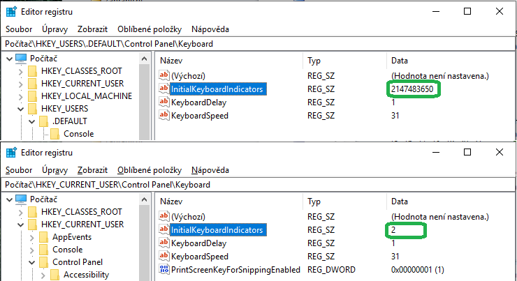

    Hello, I would like to ask for directions in Windows 10. How can be the numlock status mastered?
    there are registry values I should change, that works most of the time, but sometimes suddenly it just misbehaves. On my work notebook after switching on from the “power off” state, numlock is on. I do restart and numlock is off.
    I have the *.reg key that I run on our office computers and for some it works, for some not, but I really struggle to handle this correctly.
    I thought it should be easy to set this basic function on/off.
    Whats your way how to do that? Really appreciate every tip.

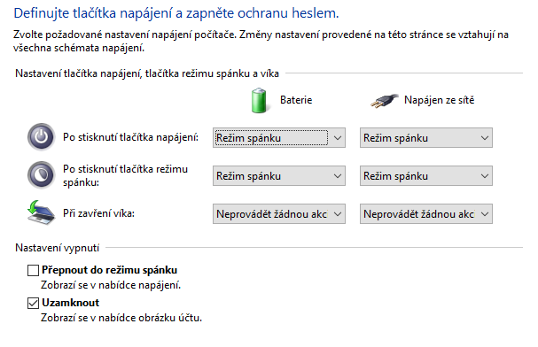

      Thank you. Wait.. Where is my fastboot option?
      whaaaat
      OK I will try on another computer.
      PRUSA i3 MK3S+
      • #2342833
        Doriel,
        If hibernation is disabled fast start is also disabled and won’t appear in the screen you posted. 😎

      Open Notepad and then copy and paste the following lines in between the two rows of asterisks into Notepad. Then save the file as “Keyboard_NumLock_ALWAYS_ON.reg”
      [HKEY_USERS\.DEFAULT\Control Panel\Keyboard]
      “InitialKeyboardIndicators”=”2”
      [HKEY_CURRENT_USER\Control Panel\Keyboard]
      After saving the above a a REG file, right-click on it and then choose to merge it into the registry. Reboot. Your computer will now boot up with Num Lock enabled. If you subsequently create any additional user accounts, those new user accounts will also inherit the new default value (Num Lock is ON) for those accounts. Also note that when you cold boot your computer, the value under HKEY_USERS\.DEFAULT\Control Panel\Keyboard is what is used.
      The above registry settings work at least as far back as Windows 7.
      The default value for both keys (at least in Windows 7) is:
      “InitialKeyboardIndicators”=”2147483648”
      Note that “2147483648” is actually equal to “0” or that Num Lock is turned off.

    • #2343174
      Or instead of using my REG file, under the DEFAULT user, change the value to “2”.
    • #2343701
      thank you, seems like the issue is resolved, by setting the value to “2”.
      In the past, I put “InitialKeyboardIndicators”=”2147483650” which seems not to work properly.
      I put “2” and it behaves nicely. thank you once again.
