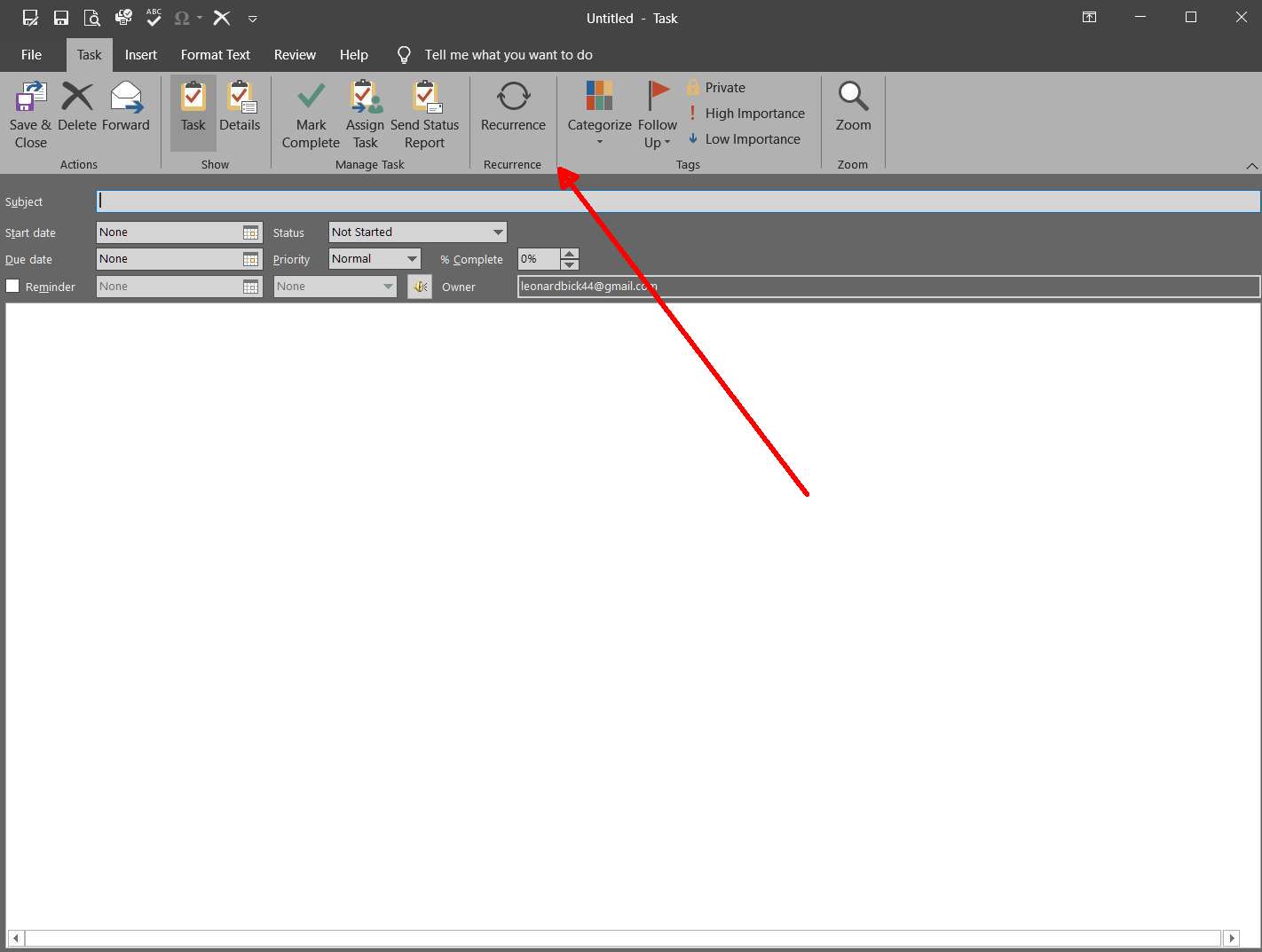

    I can create a task that does not recur, but when I hit the “Recurrence” button in the middle of the Task Ribbon (see”new task screen” attachment), Outlook crashes. Sometimes it restarts, sometimes not. If I have saved the task, the task survives. If not, it disappears.

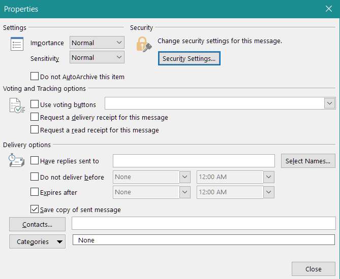

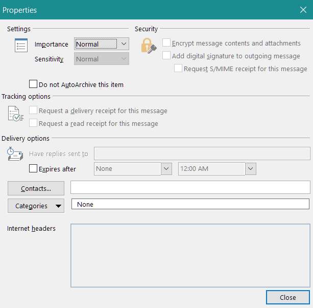

    On the Task form, if I go into File>Properties on a new task, I’m unable to change the security settings (see “New Task Prop-security” attachment). On an already created task, the security options are visible but greyed out (see “Old Task Prop-security” attachment). Don’t know if this is relevant, or why I would want to change the security options, but there it is. I can’t find any documentation on that feature.

    Thanks for any help. I’m even considering reinstalling Windows to try to get rid of this bug.
    I’m running Microsoft Windows 10 Version 1909 (OS Build 18363.535), and Microsoft
    Office 2016 MSO Click-to-Run (16.0.12325.20280) 64-bit. Also called Outlook Version
    1912 (Build 12325.20288 Click-to-Run).
