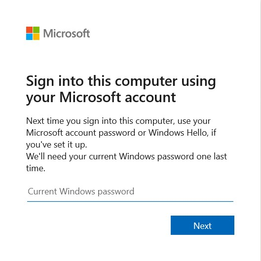

    When I try to sign in to Windows 10 using my Microsoft Account, I enter my account user id and password and then I get this.

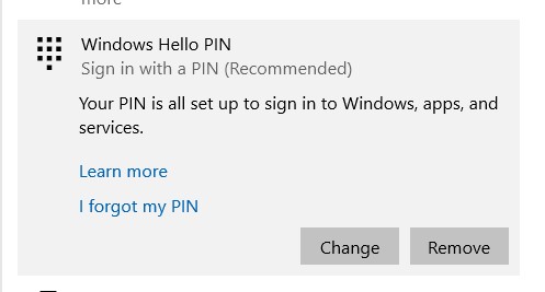

    I set up a pin over two years ago and Windows 10 says it’s done.  But this is not the password it wants.

    It also doesn’t work with my Microsoft Account password which is also supposed to be set up.
    Screenshot-2022-09-10-192800
    It doesn’t work with my local account password either.  I just don’t know what password it wants.

        I’m not on log in screen.  Windows 10 opens in my local account without sign in.  I am afraid to change that when I don’t know what password it wants.  I may really be locked out then.
        I have no memory of what my password would have been before I set up the PIN, but I feel sure it was the pw for my Microsoft Account.  When I have sign in to Windows with my Microsoft account that is the user name and password I used.  I never got this window before.
        Screenshot-2022-09-10-190807-1
        The current Windows pw is my local account pw but that does not work.  The only other pw is my Microsoft Account pw and that does not work.  And of course, the PIN does not work.

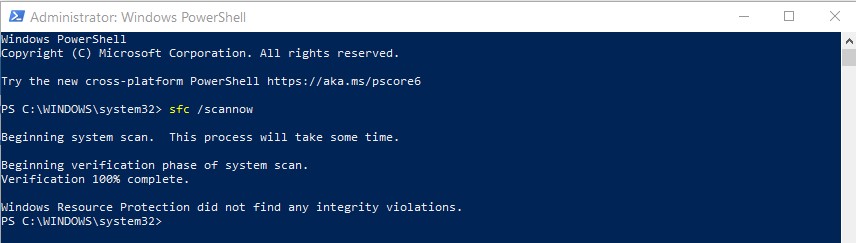

        Ran DISM scan and sfc scan.  Did not help.
        DISM-2022-09-11
        sfe-scan-2022-09-11-014030

        When I enter my user name and password I get the window above.  I don’t recall ever getting that before.  When I skip entering the password I just get demand in red letters to enter password and go no where.
        On the sign in window after I enter my user name the next widow offers other ways to sign in and I chose email and got a code but that too only got me as far as the above window which does not accept any password I have been using. And now they don’t work.
