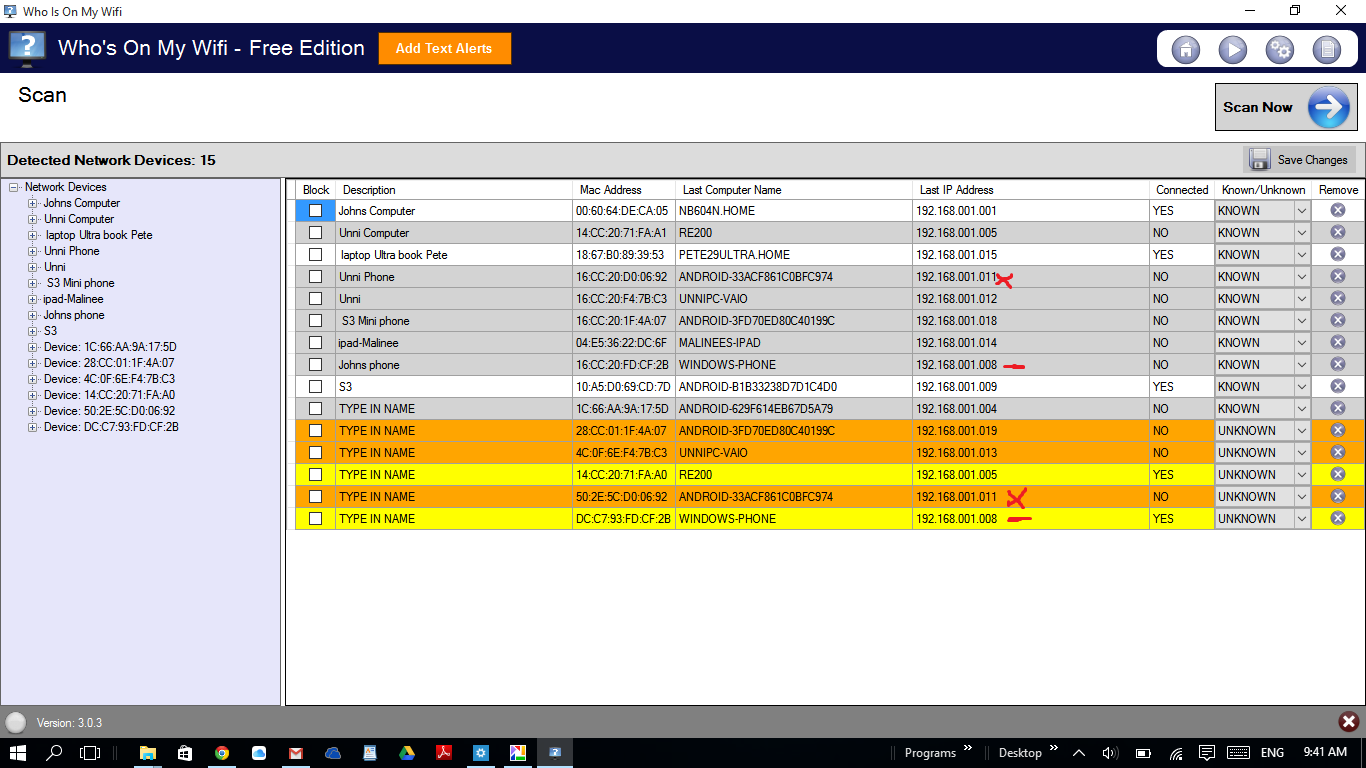

I am currently using the free version of “Who’s on my wifi” which works but I find it confusing as it adds the same computer names after each scan (not all but some) .Is there a native way to Windows to do this. I also tried “net view” in an Command Prompt but that only gives my laptop name. I have given my password to boarders living in my house until there wifi is up and running again and then I will change the password again. This is why I have a sudden interest in this. I see How to Geeks recommend “glass wire”. Thanks for any help or advice on this.

Yes it does which is pretty good really, thanks for the ideas everyone but still using “Who is on my WiFi” as really busy with work at the moment. When using “Who is on my WiFi” I get the same device appear as Unknown when I have already checked it as Known and it is the same device but with a different mac address and I’m sure it is also changing the IP address sometimes to.

Update. Can a WiFi booster in the house be causing this, I will unplug it after when suitable and test this. -

AskWoody LoungerSeptember 8, 2015 at 4:04 am #1527449Devices are identified by mac address, so it is natural that if the mac address changes, the device is identified as unknown.
Why does the mac address of the device keep changing?
I turned off the TP-Link Wi-Fi Booster and I got a normal scan on “Whos on my Wi-Fi” so that problem is solved but it is strange how that works (mac address changing)

AskWoody PlusSeptember 10, 2015 at 6:05 pm #1527798Two MAC addresses for a device is correct for my setup. I use a wifi extender (Netgear WN3000RPv3) which generates a virtual MAC when I connect a device to it. The extender passes the virtual MAC to my router (Netgear WNDR3700v4). The router sees this as a new device so it assigns it a new IP (I use dynamic IP addresses). The first time I connect a new device to the extender, it creates a table entry associating the real MAC to its virtual MAC, ensuring that the router will always see the same virtual MAC for that device. Since I use an Access Control List on the router, it ignores any MAC that is not in its authorized list. So, when I connect a device to the extender, I must to add its virtual MAC to the router’s ACL. There are times when I connect a device to the router without using the wifi extender. In that case, the router sees the device’s (real) MAC address. That’s why I have to have both MACs in the ACL.
btw – since the extender itself has to wirelessly connect to my router, I had to add its MAC to the ACL. So, the router ACL now has an entry for the extender plus two entries for each device connected to the extender – one for the virtual MAC and one for the real MAC. -
