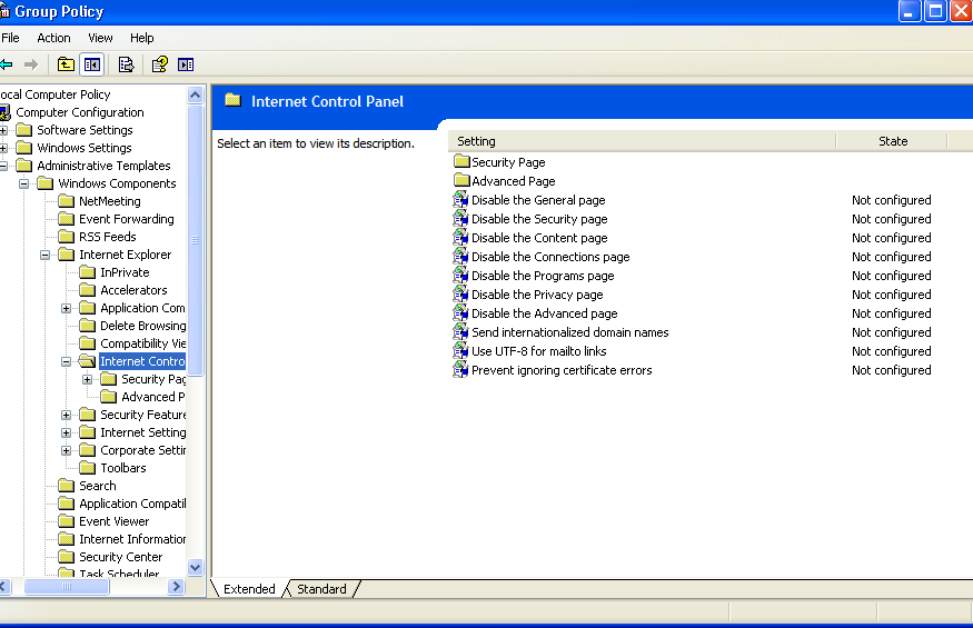

    • #1335210
      Does the Computer Configuration section look like the attached?
      31120-Capture
      Joe
    • #1335212
      31121-gpedit
      With minor variations it looks almost the same.
      Urge
