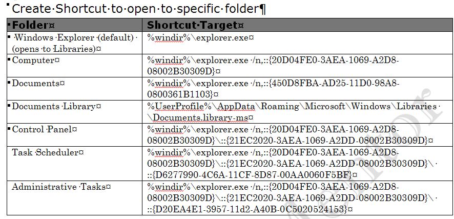

    • #1405423
      P.P.
      Let’s give this one more try:
      Code:
      %windir%explorer.exe /n,::{20D04FE0-3AEA-1069-A2D8-08002B30309D}
        [*]Click the Select All button on the above.
        [*]Press Ctrl+C
        [*]Goto the Desktop
        [*]Right-Click and select New -> Shortcut
        34613-MyComputerSC
        [*]Press Ctrl+V
        [*]Click Next
        [*]Type a name into the box like My Computer
        [*]Click Finish.
      You should now have a shortcut 34614-MyComputerIcon on your desktop that will take you directly to the My Computer listing you desire.
      34615-MyComputerWindow
    • #1405435
      I had to bring my Dell Latitude D800 out of hibernation to jog my memory. I had forgotten that XP needs the “/n” switch.
      It’s “C:WindowsExplorer.exe /n ,”
      Note that there is a space in front of the “/n” and also a space in front of the “,”. It still works the same; it’s expecting a path statement, but there’s not one, so it defaults to “My Computer”.
      34617-My-Comptuer
      — edit — I posted this from my D800 booted into XP.
