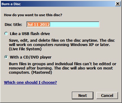

      Hi Linda,
      insert a dvd-rw in your optical drive. Right click & select ‘Open’. Drag any files you want to keep to the desktop. Now, click ‘Erase this disc’.
      When done, re open the optical drive and this will appear:-
      31429-DVD
      You can name it as you want instead of the date. These are the settings I use.
      If ‘Like a USB flash drive’ is used, your disc wont last very long.

      Also see 2 more interesting and fact-filled posts since yours: will need to spend more time reading them to understand them fully, but do understand your directions. Your screenshot is what I saw after I erased the disc and was ready to reformat it. Thanks! I’ll try that and post back once I have …
