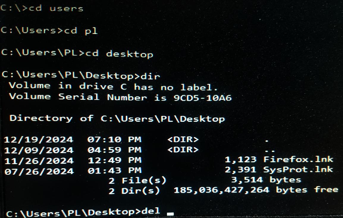

      Usually, a virus protection software will quarantine a file and you can delete it from there, so this is unusual. One thing you could try is going into “Safe Mode Command Prompt”.
      Press “Shift” and hold it, and then hit “Restart” while continuing to hold the shift key until it comes up with this menu:
      20241220_112228
      Press the “Troubleshoot” button:
      20241220_112336
      And select “Enable Safe Mode With Command Prompt”. (There are a few other menu items you need to select to get to this screen, but I’m not sure if you might not already be familiar with this or not, so I left it out. You could search how if you need more assistance.)
      20241220_112704
      So, once you get to the command line, just get to your desktop (obviously replace your User Name with mine) and delete it from there.

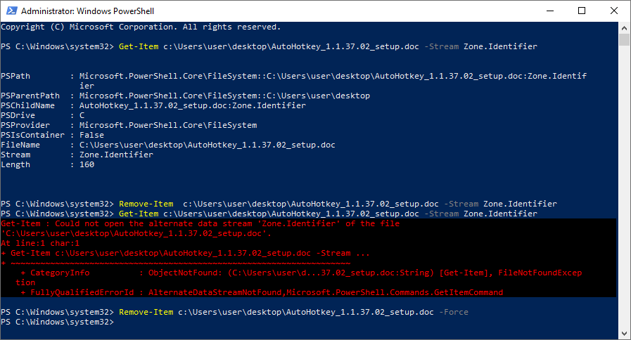

      Is there a possibility that you didn’t unblock the file after it was downloaded to your desktop?
      If so then it will have a Zone.Identifier alternate data stream attached to the file to show the OS it came from elsewhere, irrespective of its new file extension. This Zone.Identifier is a safety feature that can prevent normal file operations.
      Here’s how to check and remove any such ADS attachment using PowerShell.
      1. Right-click on Start; select Windows PowerShell (Admin).
      2. When the elevated PowerShell console opens, copy/paste/enter the following:
      Get-Item c:\Users\John\desktop\AutoHotkey_1.1.37.02_setup.doc -Stream Zone.Identifier
      (Note that you don’t need to use any quotes because there’s no spaces in the filepath.)
      The result will show you if there is indeed a Zone.Identifier alternate data stream.
      3. Next, copy/paste/enter the following:
      Remove-Item c:\Users\John\desktop\AutoHotkey_1.1.37.02_setup.doc -Stream Zone.Identifier
      4. Use the UP arrow key to repeat the command in step 2. This should show an error because there is no longer any alternate data stream attached to the file.
      5. Copy/paste/enter the following:
      Remove-Item c:\Users\John\desktop\AutoHotkey_1.1.37.02_setup.doc -Force
      Here’s a screenshot of what I saw on my device (where I log into Windows as user) when I downloaded the same AutoHotkey installer to my desktop, didn’t unblock it but renamed the file extension from exe to doc:
      powershell_remove_zone_identifier
      Hope this helps… post back your results.
