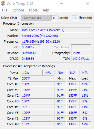

    There is something screwy going on with my processor recently.
    I use CoreTemp in the tray to monitor core temps. It used to read in the high 30’s to mid 40’sC with occasional bursts into the 60’sC. Then a few weeks back I started seeing temps soar into the 70-80’sC frequently and even hit 100C at a few points.
    I checked in with HWiNFO64 and was also seeing the same numbers as CoreTemp.
    I thought maybe a CPU fan had died (I have water cooling on the CPU) but when I looked at the fans, they were both running (sandwiching the radiator). The output hose felt fairly warm but the return hose was cool, so the radiator was working. So I decided to clean the dust out of the box and pull the water cooler on the CPU to look at the thermal paste as I haven’t looked at this in the ~7 years since I originally built this system.
    I blew out a lot of dust and the thermal paste coverage looked bad. I cleaned the old paste and then put new paste on and reseated the water cooler.
    This helped a bit and brought the temps down but they are still higher than I think they should be (in the high 40’s to mid-50’sC generally. Even when I wake the system up from an overnight sleep, the temps still show high 30’s to mid-40’s.
    This was CoreTemp temperatures a few days back when I returned to the system and woke it from deep sleep:
    CoreTemp-2023-04-26
    This was HWiNFO temp data on the same day (later).
    HWiNFO64-CPU-temp-2023-04-26
    Right now, CoreTemp is showing this and the CPU is reading about 97% idle
    CoreTemp-2023-04-30
    So with all that preamble done, the question is what is going on? How do I figure out what the problem is?  Or if there is a problem at all?
    – Looking at the 3rd CPU that got thermal throttled in the HWiNFO attachment, is it possible that the CPU is going bad? Or at least CPU ID 2?
    – If I am returning to a system that has been sleeping all night, shouldn’t I be seeing CPU temps close to ambient (around 20°C)?

    • #2555584
      Have you looked at Task Manager to see what is using the CPU?
      You could have a Crypto Miner Virus or something similar?

    • #2555632
      I would expect high 40s even with water cooling because the fans should run slowly until required – I assume they are controlled by the motherboard.
      p.s. having fans sandwiching the radiator is one fan too many. Each fan will only pass as much air as its blades will allow. 2 fans does not equal twice the air.

    • #2555854
      @ibe98765
      Ok, so your radiator is doing it’s job and you’ve replaced the thermal paste between the chip itself and the heat sink. The CPU is running barely above idle with about 0-3 percent usage at idle.
      The fan on top of the heat sink needs to be spinning at the right speed for a given temperature, OR the pump within your liquid cooling solution needs to be doing the same, running at a given speed for a given CPU temperature. This setting is usually contained within the BIOS/UEFI settings for CPU thermal management, and might even have a fancy name as well. Could it be that for some unknown reason, the setting got changed by a wayward software update that might have recently been installed for your overall thermal solution that includes the radiator that handles the liquid cooling?
      Go into your UEFI/BIOS settings to see what the settings are for the thermal management of your CPU, and see if one (or more) has (have) been changed from what might be a perfectly acceptable factory default.
      One other thing…see if the tubing/piping for the liquid is damaged in any way that would be slowing down the liquid’s flow. As alluded to above, liquid flowing slower than it should will increase your CPU’s temperature because it won’t be able to remove as much heat as liquid that’s moving faster.

        • #2556159
          Per the specs from Intel, your processor is designed to operate between 4 and 4.4 GHz, which is equivalent to 4000 and 4400MHz. So, it’s operating within its designed specs. The specs can be found on the following Intel page:
          https://ark.intel.com/content/www/us/en/ark/products/80807/intel-core-i74790k-processor-8m-cache-up-to-4-40-ghz.html
          Many terms on that page have a ? mark inside a circle next to the term. Clicking on that will help define what’s meant by the term.
          Despite the temperature difference that you can feel on the pipes on each side of the heat sink, I still think that just maybe the pump is running more slowly than it should be. Is there any way you can look up the specs for your cooling system to see if they say how fast the pump is supposed to run (in RPM)? One thing that would make it run more slowly would be if it’s not getting the full voltage it’s supposed to be getting.

    • #2556262
      As I pointed out in my above post #2555828, it’s impossible for a working CPU to be at ambient temps because, even at full idle/sleep (i.e. doing nothing), it’s still using some power and power = heat!
      As for why increasing the air flow lowered your CPU temps, the explanation is quite simple.
      The temperature of the air “inside the case” directly impacts how hot the CPU gets (i.e. the hotter the temp inside the case, the hotter the CPU will be.) Adding more cool outside air into the case by speeding up the fans lowers the “inside the case” air temps which lowers the CPU temps.
      This effect is normal for all PC’s, regardless of whether you’re using fan cooling or water cooling for the CPU.
      A consequence of this is, CPU’s tend to run hotter if located in an area with higher room temps and lower if the room temps are cooler (which is why servers are normally placed in “temperature controlled” environments with room temps ~18° C.)

        I’m finding this discussion very interesting. Having never been an over-clocker, with the exception of my IBM-PC-AT (changing the 6Mhz crystal for an 8Mhz one), but I’ve always been interested in the topic.
        I’m posting this as a reference for an overclocked CPU running Windows 10.   Overclock percentage is 29% on Asus MB.  One click overclocking using the “fast” setting, not the higher “fastest”.
        I have no instabilities on the “fast” setting.  I did have instabilities with the “fastest”
        07/2018 Home built desktop Asus MB Intel Core i7-7820X Skylake-X 8-Core 3.6 GHz. Overclocked 25%. (Liquid cooling.  Standard thermal paste)
        This CPU is one of the few 7th gen chips approved for Win 11.
        2023-05-05_16h05_42
    • #2556987
      Most everyone uses Centigrade temps when OC’ing.  It’s hard to compare Fahrenheit temps.
      Huh? Max temp is 212F. High recorded 145F. I don’t see a problem making the comparison.
      I’m also not going to tear apart a working computer that’s showing no signs of problems.
    • #2557000
      I believe he was actually referring to making a comparison with other’s results in Celsius without having to do a F/C conversion.
      The majority of user posts on the CPU topic that I have seen elsewhere use Celsius as the international standard of temperature measurement. Fahrenheit is mostly a US only standard, with a few minor exceptions. https://en.wikipedia.org/wiki/Celsius
      But use whatever suits you and allows you to manage your machine. That’s why there is a toggle in the CPU monitor program! However it’s easier to make comparisons with other users if everyone shares a common standard of measurement.
      Windows 10 Pro 22H2
