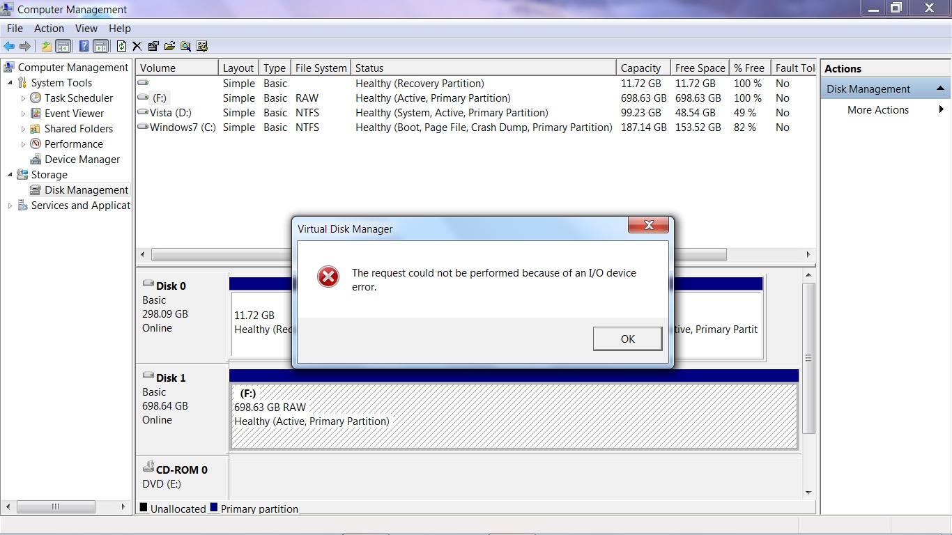

This is the error I get with the drive hooked up externally. “The request could not be performed because of an I/O devise error”.

AskWoody LoungerNovember 2, 2011 at 10:30 am #1305040WSInfinicore

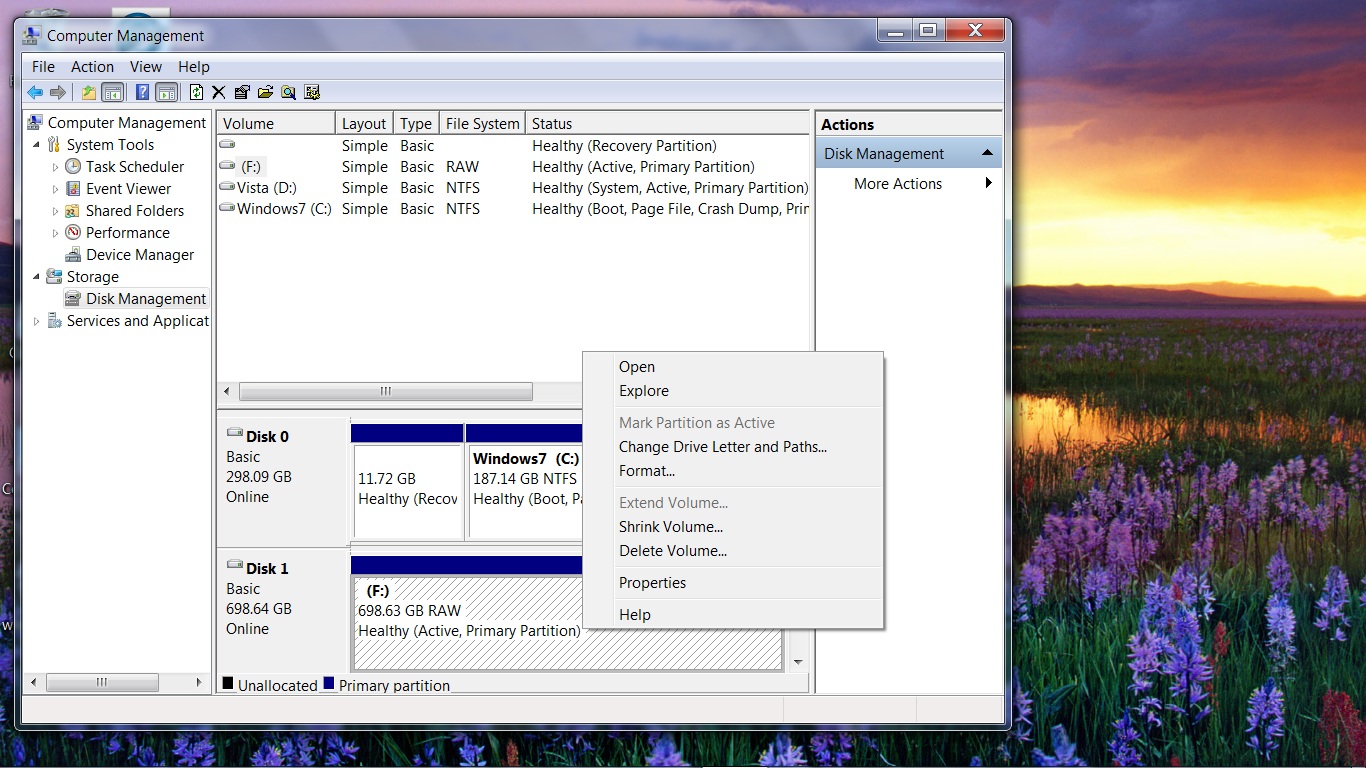

AskWoody LoungerNovember 2, 2011 at 2:24 pm #1305074You should get the following options if you right click on the little square to the left of the drive space graphic representation. I don’t get the convert to MBR because its already MBR so you might see that as well.
If that is where you are right clicking and resulting in the first image (second one is right clicking on the the partition/raw space itself which isn’t what you want) then its not going to work in Windows 7 so you may need to use GParted or another partition program to see if you can write a new partition table to the drive.

AskWoody LoungerNovember 2, 2011 at 3:51 pm #1305079You should get the following options if you right click on the little square to the left of the drive space graphic representation. I don’t get the convert to MBR because its already MBR so you might see that as well.
These are the same options I get also. GPT is grayed out. So when I tried to change the partition to dynamic I get ” The operation is not supported by the object”

AskWoody LoungerNovember 2, 2011 at 5:25 pm #1305087So it looks to me then that the MBR info is there and reading some sort of partitioning exists, therefor GPT is greyed out, but any action directed to the disk errors out.
The only thing left in my bag of tricks is to use a boot disc of Parted Magic, which contains GParted that I’ve been mentioning, and force the rewrite of the dos-type partition table (MBR). It will either do it, or if it doesn’t, I think the drive might be a goner as all previous tests seem to indicate.
