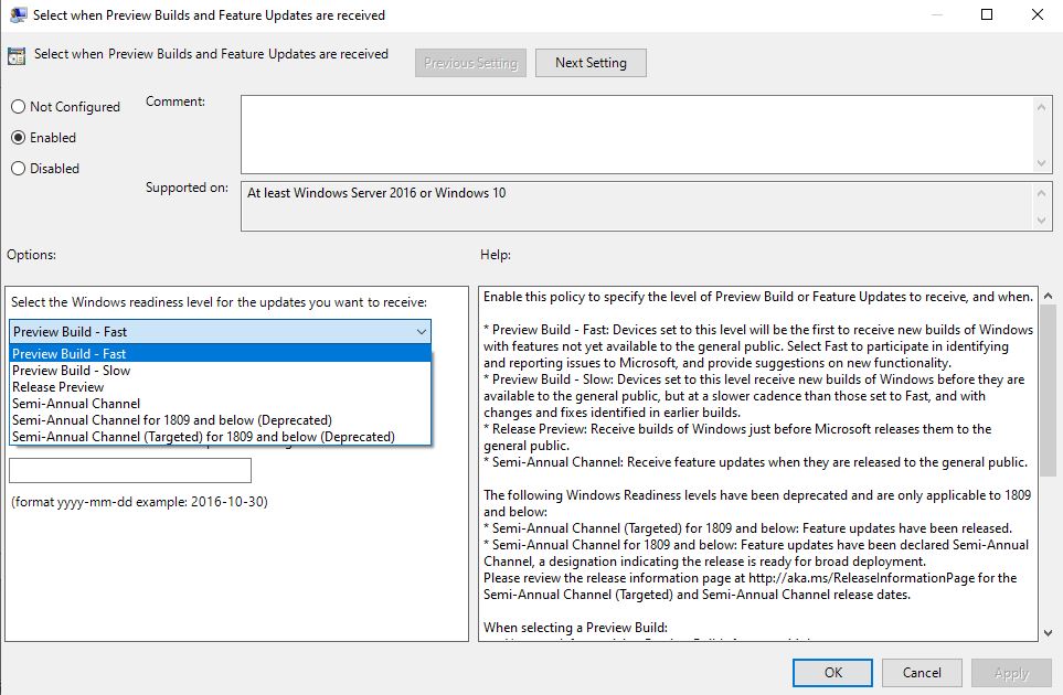

    I was reading the newsletter today and read Susan’s column about group policy settings and decided to check mine (which have been set for some time to Semi Annual Channel 365 days).
    When I checked this morning, there are now new selections (which evidently changed when I went to 1909) to Preview Build-Fast instead of Semi Annual Channel.
    grp-policy-settings
    Should I move back to Semi Annual or just leave it as is.

    • #2289200
      I believe That is going to put you in the Insider Preview Builds.
      You should go back to Semi Annual Channel. That will give you Patch Tues Security Updates but not the C, D, E week Previews.
      Go look at AKB2000016, particularly the information for 1909 (Sections 3 & 4) and the screenshots below for those sections.
      • #2289205
        Thanks PK but AKB2000016 doesn’t mention any of the Preview Build Fast/Slow etc. so I guess I will go back to Semi Annual as it was before. Even with the Preview Build Fast set at 365, it hasn’t allowed 2004 yet.

            • #2289596
              What concerns me more, that @CADesertRat ‘s settings were overriden by MSFT. They obviously put him into betatest channel, while he states
              Just to point out, this evidently happened after I went to 1909 and at that point the GP was still correct but has since changed so I believe that it must have been 1 of the cum. updates that caused the wording/selections in GP to change.
              BTW, it changed on ALL the computers in the house with 1909 and wasn’t noticed until after the July updates so draw your own conclusions. If you are using GP, you may want to check your settings.

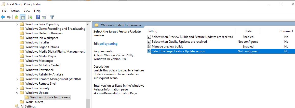

    • #2289208
      If you want 2004 to be offered, set the Feature deferral to 50 days
      OR
      Use the Target Release Version setting = 2004
      + Setting Target Release Version – This can be used to specify when Preview Builds and Feature Updates are received instead of using feature update deferrals. The settings can be made in two ways in Win10 Pro. (See screenshots in #2286499 below.)
      You can make manual entries in the Registry as described in Section 2 for Win10 Home. But an easier way in Win10 Pro is using Group Policies. In Group Policy use these settings:
      Computer Configuration\Administrative Templates\Windows Components\Windows Update for Business
      Select the target Feature Update version = Enabled, Target Version for Feature Updates = 1909 (or whatever version you want to stay on, or upgrade to)
      Making the settings in Group Policy will set the corresponding Registry settings in the proper location. So you do not need to use both methods.
      **NOTE: It should also be noted that if the device is not updated before it reaches EOS, the device will automatically be updated once it is 60 days past end of service for its edition.

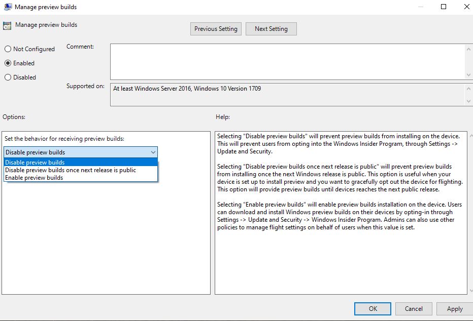

      • #2289216
        I do not want 2004 so I set it back to semi Annual and also set Disable Previews to enabled.
        Disable-Preview-Builds
        WU-4-Business
    • #2289235
      Will those settings keep 2004 away?
      • #2289240
        Set the Target Release Version to 1909 – but read the caveat in the **NOTE
        With Feature deferral at 365 days you should be safe for a LONG time.
        You probably don’t need the other stuff. My example in Section 4 is all I use and I haven’t EVER been pushed as long as I watch the 365 days and don’t let it expire. All I use is the “2” (notify download/install) and the Feature deferral = 365.
        • #2289245
          Would that be necessary with the settings that I have made already or should it be in addition to the other settings already enabled? EOL for 1909 should have quite a way’s to go shouldn’t it?
          • #2289289
            v1909 will not reach end of life until 11th May 2021. See the Windows 10 release information page for more details.
            So, with the Feature deferral pulldown set to 365, that would mean v2004 will be offered on 11-12th November this year, as that is a year after 1909 was released.
            I imagine by then v2004 will have most of the bugs ironed out, but if not the Target Feature Release version set to 1909 in Group Policy would prevent you from being offered v2004 (at least, I believe so) past the v1909 anniversary and would not install a newer Feature update until 60 days after v1909’s end of life – which means you could feasibly stay on v1909 until on or around 11th July 2021.

    • #2289300
      I have been using gpedit happily for quite some time (also use 2=notify before download) until I saw the changes this morning in choices/terminology.
      As to 2004, When there is an ok and the bugs are worked out I will do as I usually do for a Feature Update. I will go to gpedit and change the 365 to 0 and then click on resume updates to get 2004 and then go back to gpedit and reset it to 365 days along with pausing updates for 35 days.
      When I saw the “Preview Build Fast” terminology, it scared the heck out of me LOL, hence the questions.
