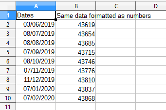

    • #2137778
      Change the cell format to numbers and compare – dates are just numbers formatted to look like dates.

    • #2138331
      This is a sample I whipped up.

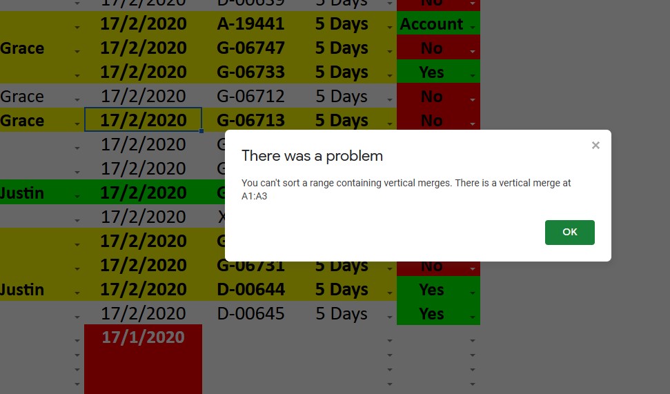

    • #2139979
      As requested. I have a similar error when using Excel (but doesn’t mention which). Is it supposed to autosort?
      Annotation-2020-02-13-163755
      • #2139984
        The first few rows of columns A – E are merged together for some reason. Undo that bit of nastiness (or exclude that merged row) and the sort will probably work.
