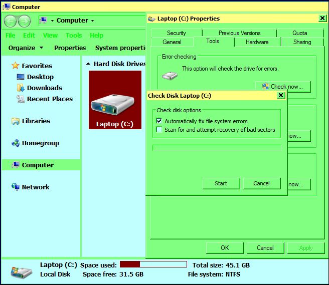

      Hi maccers4321, Welcome to the Lounge.
      Run check disk (chkdsk) on the hdd.
