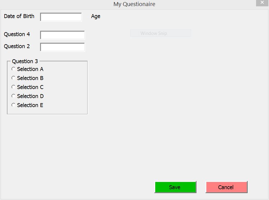

      Kerry,
      Here’s a roughed out User Form that shows how you can accomplish what you are after including:
      39993-KerryUserForm
        [*]Calculating the Age (I used a routine from the internet which is a little more accurate than your formula).
        [*]Showing either Question 1 or Question 4 in the same space below the DOB:
        [*]Providing a group where only one answer can be selected.
        [*]Saving the data back to the worksheet.
        [*]Placing a button on the worksheet to run the form.
      If this is what you’re after we can help you flesh out the rest of the solution if you are not familiar with VBA forms.
      Test File: 39992-KerryG-Validation-Sample
