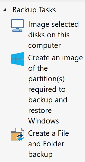

      6) Regarding your image… which did you do?
      MR-Image-to-Restore-Windows
      Question 1-4 is correct.  Before this began I purchased the new harddrive and USB to SATA enclosure largely inspired by this article.  https://www.pcmag.com/how-to/how-to-clone-a-hard-drive
      I have been using Macrium Free.  I couldn’t get clone to work.  Imaging the current, old, internal laptop harddrive worked with no issue.  I saved that to the newly purchased harddrive using the USB to SATA enclosure.  I want to install the new harddrive internally replacing the old one.  Based on the article, I thought I could just clone, or now, image the old to the new and then remove the old and install the new and everything would be exactly as it is now.
      Question 5.  I thought cloning or even imaging my current harddrive meant everything would be identical once on the new harddrive and using that.  I was not aware that I would need to worry about any reinstalling, licenses and what not.  Honestly, the article made me think I was just going to be able to clone everything from the old to new drive, and other than it being on a new drive versus the old, nothing else was needed.
      Question 6.  There was actually another option in Macrium that I used both during the cloning and imaging.  When Macrium opens it automatically selects the current active disk and partitions on its home page and right under those it offers a choice to clone this disk or image this disk.  I used those rather than the attached screenshot options on the left.  But, that said, I just confirmed that the option in your screenshot that says “image selected disks on this computer” is identical to the one I used that said “image this disk”.  That automatically selects my current old internal laptop harddrive with all partitions selected.  I then just followed the prompts and selected the new harddrive as the destination for the image.
      I have the intended complete image of my current old internal laptop harddrive but it is currently saved on the new harddrive that I intended to install in the laptop, replacing the old one.  The issue, since it is an image rather than the hoped for clone, I have to boot to something else before I can restore the image.  The question is whether I am allowed to have that image saved on the new harddrive I want to install into the laptop, replacing the current old one, and use a USB Flash drive with bootable rescue media on it and that will restore the image on the new harddrive.  Or, if I need to have both the saved image AND the bootable rescue media on the same third drive in order for that third drive to then restore the image to the second new harddrive that I purchased to install internally in the laptop replacing its current old harddrive.

    • #2281813
      …have you tried the built-in windows system image tool under Backup and Restore? I’m surprised nobody mentioned it but that’s what i used and it worked for me. I don’t want to add to your complexity but if Macrium keeps throwing up that error then it’s worth a try. Of course then you need to purchase some external storage on which you save the system image but you should have one of those for backup anyway and i highly recommend one of the little WD portable drives. I have a WD My Passport Ultra 1TB but i didn’t restore from that because i have a desktop PC and restored from an internal WD Black drive.
      Hope you get it sorted out.
