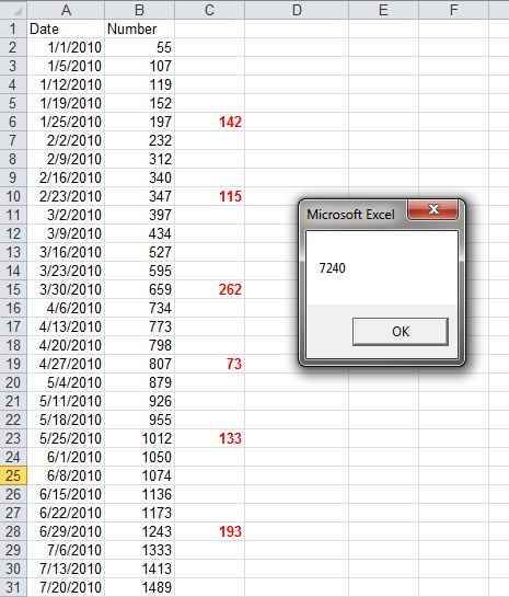

    • #1469286
      Skipro,
      The file I provided does total the difference of first and last day of each month and places the value adjacent to the last day in column C. See the image in my above post. They are not max and min differences.
      The code you placed in the file was not pasted correctly. Somehow 3 lines of code were pasted on the same line:
      Dim Total As Double, SubTotal As Double, I As Integer LastRow = ActiveSheet.Cells(Rows.Count, 1).End(xlUp).Row StartRow = 2
      There was also a missing End Sub. See my posted code above. Here is a screen shot of your spreadsheet with the code pasted correctly.
      HTH,
      Maud
