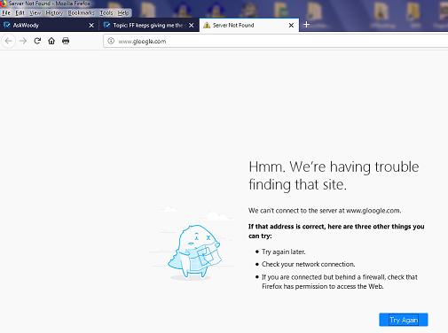

    • #2436124
      Does the timeout message ‘somewhat resemble’ this?
      NotFound
      Are you using a Bookmark to access the site?
      1. Try directly keying in the site address to the address bar.
      2. Please copy directly from the error page the site address, and post it here.

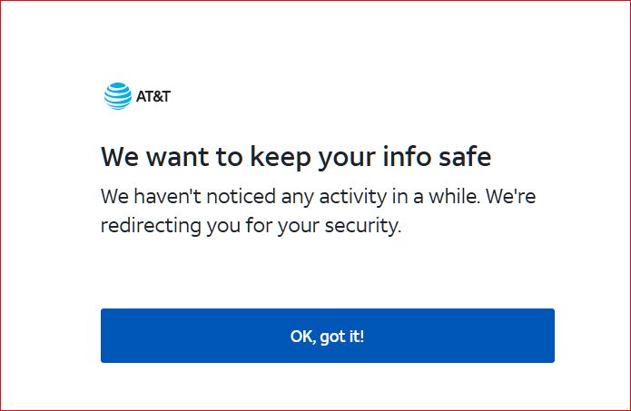

      • #2436169
        I would get this sign-in screen (there’s actually more to it with tabs for News, Finance, Sports, Entertainment, Games, my account, News snippets (with links), weather info, sports scores, horoscope, etc):
        Sign-in-screen
        And when I clicked on the Sign-in button, then I would get the login page asking for User ID and Password, but afterward that (after logging in), I would get this timeout message. Mind you, I had not been inactive, but it says I was. When I clicked on the ‘OK, got it” button, I would be back to the sign-in screen.
        Timeout-message
        Post edit: Let me start over. This loop would begin when I was actually using the emailer and the timeout message would suddenly appear. So, then it would take me to the Sign-in screen, the Sign-in screen, after signing in, it would take to the timeout message, which would take me to the Sign-in screen, which after signing in, would take me to the timeout message, ad infinitum.

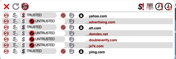

      With NoScript you have a list of blocks you can make on a site. For example: allow att.net, att.com, yahoo.com but block: advertising.com, demdex.com, js7k.com
      That way, you get the site but not the ads.

        • #2436256
          NoScript sees what scripts the sites are trying to run on your computer and lists them.
          Here’s the one for my ATT.net email. As you can see, I have blocked ad pushing sites, and allowed the critical ones to run the email. I don’t get ads on the right side of the email window. There is also option for a temporary allow that goes away when the browser is closed or you click the “clock” on the far right.
          Screen-Shot-2022-04-02-at-5.59.41-PM
