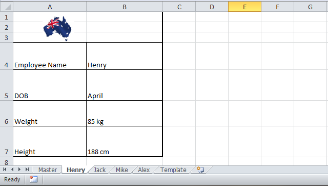

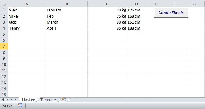

        Thanks Maudibe. The codes work perfectly. I am however trying to take this one step further but I ran into bit of a problem.
        Here is bit of a background on what I am trying to achieve. I have a workbook with 2 sheets:
        Sheet 1: List of names and information associated with it. (eg. list of employees and their dob, weight, height etc)
        Sheet 2: A template which contains the field to enter the employees name, dob etc. The template is setup with vlookup so the program only needs one field to be copied from sheet 1 to the new sheet and vlookup will do the rest.
        Using your codes I want to create a new sheet for each employee with all the associated information using the template.
        So basically the code needs to copy two separate things.
        1. Copy the template to need sheet and name the sheet as per the employee name.
        2. Copy the name of the employee to a distinct cell location.
        I have managed to to do both of these by playing around with your codes but when i copy the template across, it loses some of its formatting like cell sizes and a logo I had on the template.
        So my question is: Is there a way to copy a sheet across without losing any of the formating?
    • #1421410
      Paras,
      Here is some code that will create a new sheet for each of the names on the master sheet. It will name the sheet to the name of the person and then copy the data to the appropriate cells in column B. The code is activated by a button but you could add this to the Workbook_Open or WorkSheet_Activate event subroutines. If you have the same name in the list, the code will name the sheet “Template(2)” and still continue to run. You will not need the Excel vlookup formulas nor the code that you have in the ThisWorkbook module.
      Hope this is what you are looking for,
      Maud
      35360-Names1 35361-Names2
      Code:
      Public Sub EmployeeSheets()
      On Error Resume Next
      [COLOR=”#008000″]’DECLARE AND SET VARIABLES[/COLOR]
      Dim Master As Worksheet
      Set Master = Worksheets(“Master”)
      LastRow = Master.Cells(Rows.Count, 1).End(xlUp).Row
      [COLOR=”#008000″]’————————————————–
      ‘CREATE NEW SHEET AND COPY DATA[/COLOR]
      With Master
      For i = 1 To LastRow
          Sheets(“Template”).Select
          Sheets(“Template”).Copy After:=Sheets(1) [COLOR=”#008000″]’CREATE NEW SHEET[/COLOR]
          ActiveSheet.Name = .Cells(i, 1).Value  [COLOR=”#008000″]’ASSIGN NAME[/COLOR]
          [b4] = .Cells(i, 1) [COLOR=”#008000″]’COPY DATA[/COLOR]
          [b5] = .Cells(i, 2)
          [b6] = .Cells(i, 3)
          [b7] = .Cells(i, 4)
      Next i
      End With
      End Sub
      • #1421423
        Thank you! This is exactly what I was trying to achieve. Your codes are perfect.
        Paras
