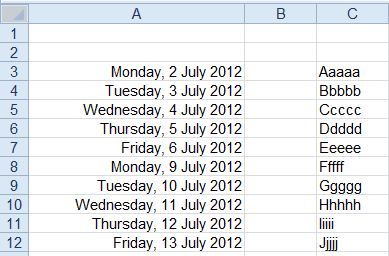

    However it appears that the putting the Named Range or a cell address as the function parameter transfers the value contained in the cell to the function, rather than the cell/named range address, consequently the result returned by the function is #VALUE!
    Here is my named range:
    32381-20121116-JunkTestAddress-Data-Table
    Commenting out the JunkTestAddress line results in the MessageBox displaying the value contained in cell referenced by rngA:
    32382-20121116-JunkTestAddress-Dialogue
    The result I am looking for is rngA = $C$3.
    How can I transfer the function cell/range address parameter into the function so I can manipulate it? (Putting “” around rngA parameter when using the function and treating it as a string does not appear to resolve the issue.)

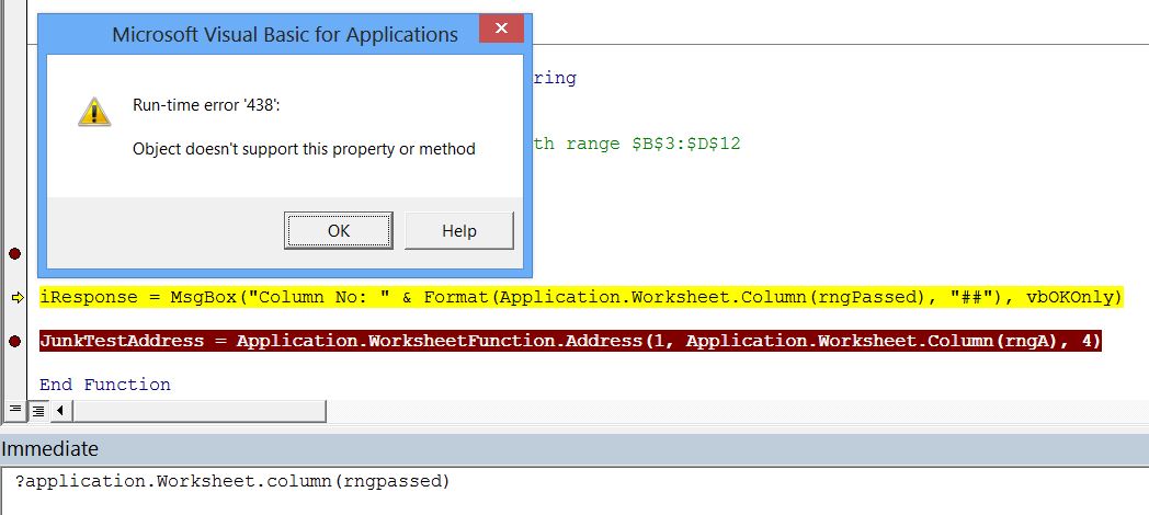

    • #1357736
      B-A-B,
      VBA does not like the Application.Worksheet.Column!
      32415-WorksheetColumnError
      It doesn’t seem to care if I use the rngA or rngPassed values.
      The only thing I can think of right now is to write code to breakdown the string reference e.g. [noparse]$B$3:$D$12[/noparse] to extract the column. :cheers:
