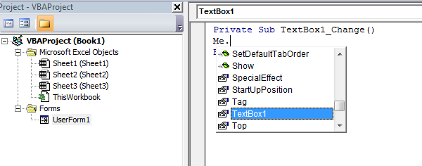

    • #1527934
      I only got in the habit of using when two forms may be interacting. For example, if the textbox1 on form A influences or is influenced by a textbox on form B
      Me.TextBox1.Value = UserForm2.textbox7.Value
      The Me keyword helps me keep it straight which user form each textbox belongs to. If you are dealing with a control (ex. textbox) on the userform in the module of that userform then you do not need to specify Me or the userform name. However, if you are using a control on another userform (as above), you must specify the other userform’s name.
      The other big advantage of the Me keyword is that you get the benefit of Intellisense. Typing Me followed by a period offers a dropdown with all the properties, methods, and controls to select from.
      42042-MeKeyword1
      HTH,
      Maud

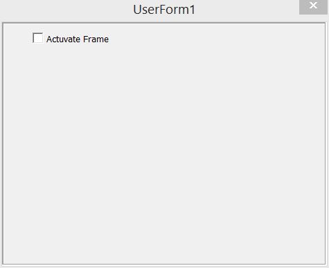

    • #1527940
      JAATR,
      If your objective is to draw attention to the frame & option buttons an alternative is to hide the frame (the option buttons hide with it) and then unhide it when the checkbox is clicked.
      42043-JAATR1
      42044-JAATR2
      Code:
      Option Explicit
      Private Sub UserForm_Activate()
         With Me.Frame1
             .Visible = False
      '       .SpecialEffect = fmSpecialEffectSunken
      '       .BackColor = vbRed
         End With 'Frame1
      End Sub
      Private Sub cboxActivateFrame_Click()
         If cboxActivateFrame Then
           With Me.Frame1
               .Visible = True
      '         .SpecialEffect = fmSpecialEffectRaised
      '         .BackColor = vbGreen
           End With 'Frame1
         Else
           With Me.Frame1
               .Visible = False
           End With 'Frame1
         End If
      End Sub
      Another option is to change the back color of the frame (see commented out lines above).
