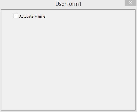

      If your objective is to draw attention to the frame & option buttons an alternative is to hide the frame (the option buttons hide with it) and then unhide it when the checkbox is clicked.
      42043-JAATR1
      42044-JAATR2
      Code:
      Option Explicit
      Private Sub UserForm_Activate()
         With Me.Frame1
             .Visible = False
      '       .SpecialEffect = fmSpecialEffectSunken
      '       .BackColor = vbRed
         End With 'Frame1
      End Sub
      Private Sub cboxActivateFrame_Click()
         If cboxActivateFrame Then
           With Me.Frame1
               .Visible = True
      '         .SpecialEffect = fmSpecialEffectRaised
      '         .BackColor = vbGreen
           End With 'Frame1
         Else
           With Me.Frame1
               .Visible = False
           End With 'Frame1
         End If
      End Sub
      Another option is to change the back color of the frame (see commented out lines above).
