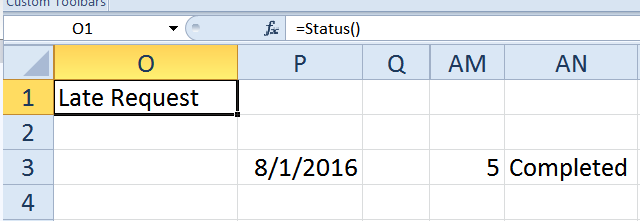

      You simply enter the formula: [noparse] =Status()[noparse] in the cell where you want the status to display, you didn't specify this by the way.
      Example:
      45045-Status
      Note: I hid a lot of columns to make the example use the same addresses as you posted.
      Here's my Test File: 45046-Status
      Note: The code can be easily changed to Calculate the test dates based on a date cell in the workbook so you could easily change the target dates w/o having to adjust the code.
