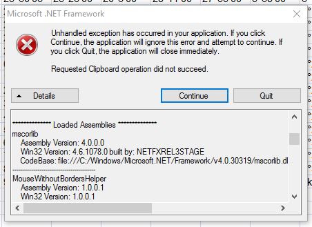

      After one of those test runs while attempting to shutdown Excel I received the following dialogue:
      After this message the only way I could Kill Excel was by “End Process” in Task Manager.
      As there are numerous instances of a cut/paste process in this procedure, this looks like it could just be where the processing stopped on this one occasion, as I’ve been unable to find any errors in the .Range.cut coding.
      The clue to the issue is probably in the error message Description: “A problem caused this program to stop interacting with Windows.” I’ve googled the “Problem Event Name: AppHangB1” but as yet haven’t found anything conclusive as to the cause and no definitive solution. Seems I need to keep searching.
      Experimenting: I have an old old computer with an Intel core2 6320 @ 1.8GHz single core CPU running Windows 10 Pro with 2GB RAM and Excel 2007. On this computer the process runs, but Status Bar “Clean CSV DATA Progress:…” indication disappears after around 15% to 20%, Excel indicates it is “Not Responding”, but in fact keeps processing (Task Manager reports CPU at ≈80%, Excel process at ≈35%) and after waiting a while Excel “returns to life” and the process has successfully completed running. I’ve run the test 10 times on this computer, nearly always with the succesful result. On one occasion I received the following error dialogue:
      Clicking “Continue” showed the process had completed successfully regardless of that error dialogue.
      The full report from this error dialogue is:

      I’ve only seen this error dialogue once, and accordingly have not been able to invoke “just-in-time” debugging.
      Does this provide any useful clues to resolving this issue?

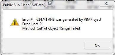

        ErrorMessages:
        Button = vbExclamation
        Title = "Public Sub CleanCSVData()..."
            Msg = "Error #:  " & Str(Err.Number) & " was generated by " & Err.Source & vbCrLf & _
                  "Error Line:  " & Erl & vbCrLf & _
                  Err.Description
            Response = MsgBox(Msg, Button, Title)
        End Sub
