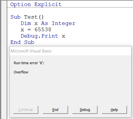

      While we’re throwing things at Excel to see what will stick I noticed that you are using an Integer type (max 32,767 for the row reference since even in 32 bit Excel the rows exceed an integer you might want to change it to a Long?
      44246-vbainteger

        I can’t work out where you saw “Integer” because “Find” never found it in that procedure. I generally use “Long” for the very reason that the range of numbers in “Integer” is limited to -32768 to +32767:confused:
        d
        My bad for not looking further. I “assumed” you were using Hungarian Notation, e.g. iRowCount meaning Integer Row Count.
