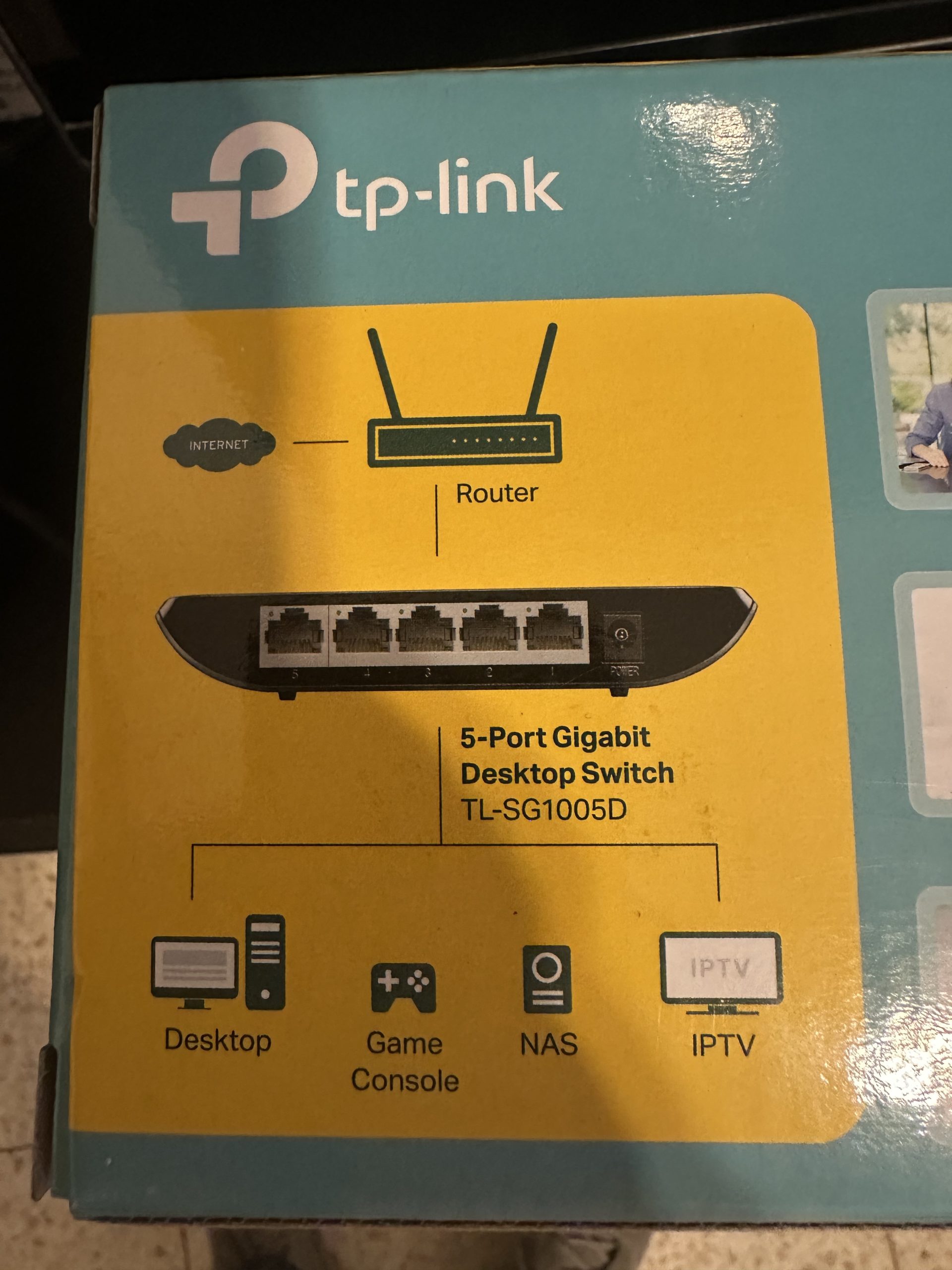

    • #2708239
      I am using a 1GB 5-port TP-Link switch for my Network. Works fine.
      IMG_2589
      IMG_2590
