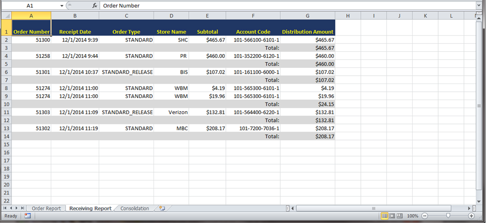

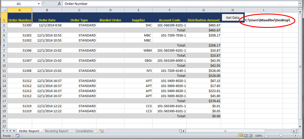

      Attached is a workbook that takes a different approach in the form of a “master template”. Clicking the “Get Data” button will initiate the coded that will prompt you to navigate to your source file with the data (.xlsx). Once selected, it will open and import all your data into the master. The master sheets will be renamed the same as your source file and the source file will then close. The data on the two master sheets will be formatted and summed according to your specifications. A third master sheet called Consolidation will pull the files over and validate them giving the messages that you had indicated for various scenarios. I also included a scenario where there are matching order numbers with a receipt but with no order date. Please see the images below. Finally, the workbook will automatically be saved to the path folder you specify in Cell I1 with the same name as the source file but macro enabled (.xlsm). In this manner, the master template is never overwritten and resolves the issue of using it monthly with a different source file.
      HTH,
      Maud
      Order Report (Cell I1 has path. Make sure path ends with a backslash)
      39243-OCM1
      Receiving Report
      39244-OCM2
      Consolidation Report (Verification of missing or non-matching Distribution amounts, and Receipts with no orders)
      39245-OCM3
