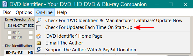

    • #2618069
      It still works just fine but, to avoid the Unable To Retrieve Version Info From The Internet. error, you have to disable the “Check For Updates Each Time On Start-Up” option under the On-Line menu item.

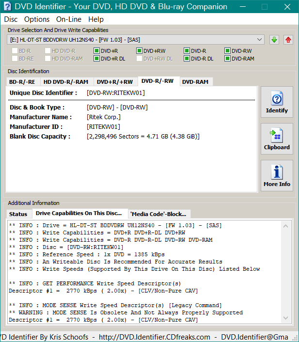

      DiskIdentifier
      Yes it still uses the old 10-jan-09 manufacturer’s database (the manufacturers_v3.dat file in the Data folder of the installation location on your system) but there really haven’t been many, if any, new DVD manufacturers since then and it does still properly ID disc as shown in the below screenshot for one of my own discs.
      DiscInfo
