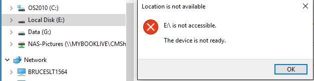

      In my case here the Windows 10 install is seen as C: and the Windows 7 install is seen as E:
      Which means that in the Registry for the Windows 10 install I have to hide the E: drive and in the Windows 7 install I have to hide the C: drive both per the Regedit codes shown above.

      If I try to Open the E: drive I get this:
      44567-DBErrorMsgNonActiveDrive
