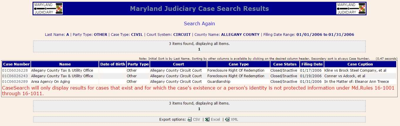

        Maudibe had the right idea: partitioning the data. I chose to focus on the other filters, since the initial letter really can’t be extended. After refining each filter, I checked against the letter A. Each result returned over 500 until I got to the last filter: time range. Arbitrarily, I chose 01/01/2006 – 01/31/2006.
        Finally! 3 results!
        43573-lounge-md-search
        Upon further reflection, this is a good range, as the number returned is less than a page. (If the developer can use sockets, this will be irrelevant.)
        At the worst, nearly 20,000 searches have to be done for each time range. Here is a summary:
        Partitioning Scheme:
        26 Initial: Must use only one letter, due to single letter entities like A & L
        24 County: Maryland has 23 counties and one independent city
        4 Case Type: Civil, Criminal, Traffic, Civil Citation
        2 Court Type: Circuit, District
        4 Party Type: Attorney, Defendant, Plaintiff, Other
        ?? Time Range: 1 month
        So for each time range, create 26 * 24 * 4 * 2 * 4 = 19,968 searches.
        Optimizations are possible. OP didn’t mention whether client was interested in the entire database. For example, if only one county is required, the searches per time range would go down to 832!
