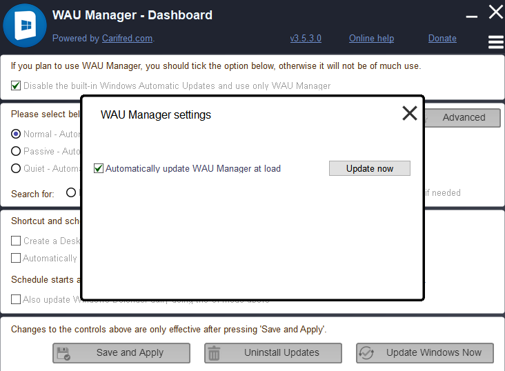

    • #2666759
      so always download & run the latest version of that app & replace the old version
      Or, set it to update on start…
