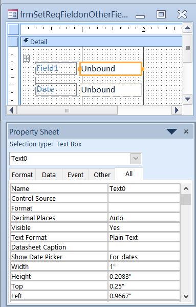

      46595-Access-Field-Unbound
      Notice how in the above form the field Text0 is UNBOUND, e.g. not tied to a database field. You can still refer to its value as Text0.value
      So that’s how you set up your fields and check them in your code.
      46596-Access-button
      Notice how the Visible property of the button is set to Yes. Change it to No and it disappears. So in your Form Open event you set it to No then in your after update event of each field you call a routine that checks to see if you have enough information for a good record. When the conditions are met you set the button to visible e.g. cmdTestForm.Visible = True (same as Yes)
