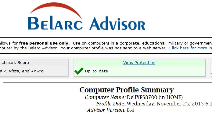

    • #1539144
      Richard,
      Another way is the FREE Belarc Advisor.
      42737-belarcadv
    • #1539255
      Thank you both. Will work up a lesson for my classes to pass on the important information.
