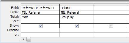

    To solve this problem, the previous Database Admin created a query called “MaxofReferrals”.
    28809-MaxOfReferrals
    The clients (called “PCs”, not short for Personal Computers) are set to “Group By” on the Totals row and the ReferralID’s are set to “Max” in the total row.

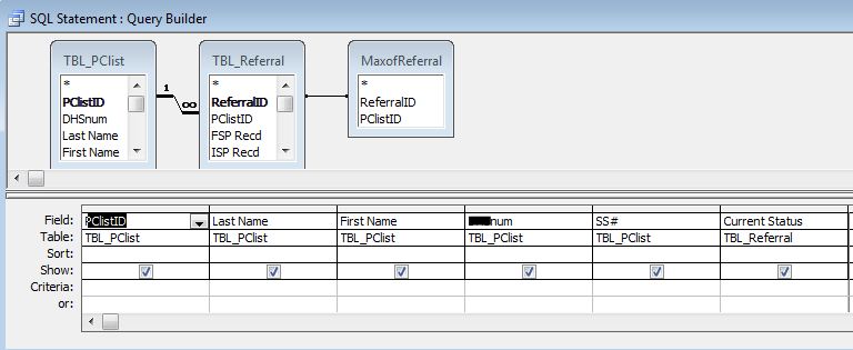

    Then I created a second query called “Main List” which displays the ID, name, social security #, status, etc. which is linked to the MaxReferral table. Running that query generates a list that shows each person once. I have it set you can click on the name, and it goes into the full record of the client.
    28810-MainList
    Here is the problem:
    Some of the ReferralID’s for newly keyed referrals into the database were assigned autonumbers that are lower than the older referral number for a client. So when the list displays, the older referral record is showing up in the list, not the newely keyed referral.
    How can I fix this? I am thinking I need to change the first “MaxofReferrals” query so it sorts on the “DateReferralReceived” field. I tried this with no success, as setting the Totals row to “Max” for a date field didn’t work.

    • #1295832
      You can use Max for Date fields, and that is what I was going to suggest.
      When you add that field to the Group By query need to remove the ReferralID , so that you only Group By the Client.
      • #1295922
        If you notice in the second image, the queries TBL_Referral and MaxofReferral are linked through the “ReferralID” field, so how can I remove it?
        • #1296691
          I see that you have a solution using the approach suggested by ruirib. I have been away for a few days.
          You cannot group by ReferralId and use Max of Ref Date as the ReferralIDs are all distinct. Once you group by them, you just get all the records returned.
          Once you remove the ReferralID, you need to join on ClientId and Ref Date instead.

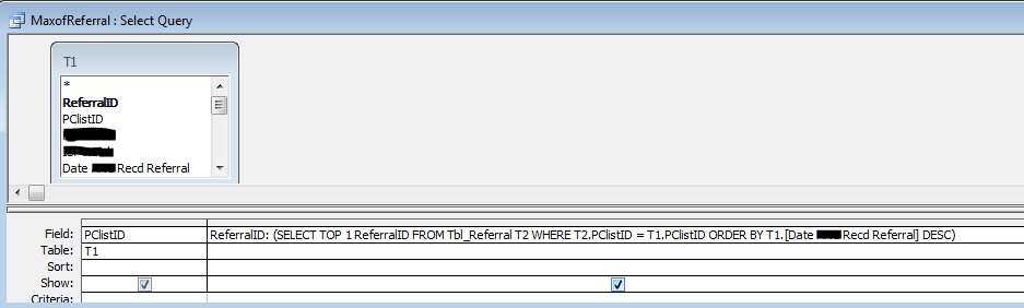

      One way to solve it. Create a new query, do not add any tables to it and choose SQL View for that query. That will lead you to a window where you can paste the SQL for that query. Paste this SQL there:
      Code:
      SELECT DISTINCT PClistID, (SELECT TOP 1 ReferralID FROM Tbl_Referral T2 WHERE T2.PClistID = T1.PClistID ORDER BY DateReferralReceived DESC) As ReferralID
      FROM Tbl_Referral T1
      Save the query and use it as a replacement for the MaxOfReferrals query.
      I am expecting it to work without any issues, but there may be some mistake on table or column names. If so, please post saying so.

        First I fixed the field name to T1.[Date XXX Recd Referral], and then it ran with this error: (note that my org name is X’ed out)
        “At most one record can be returned by this subquery”.
        28825-MaxofReferralQuery
        Here is an example of what the final window looks like (not the embedded MaxofReferral query):
        28828-MainList2
        Note that the problem is that the “Ref. Status” (Referral Status) is not picking the most recent referral for all the people the list, which is why I am trying to sort the underlying query of this list with a query not based on the ReferralID by the “Date XXX Recd Referral”.
    • #1296022
      The T1 prefix was not needed, but adding it causes no problem either.
      That error message seems to suggest that you have more than one referral for the same client done at the same date. What criteria should be used to untie such cases?

    • #1296182
      It’s easy to solve the problem, you just need to add another field to the ORDER BY clause in the query.
      SELECT DISTINCT PClistID, (SELECT TOP 1 ReferralID FROM Tbl_Referral T2 WHERE T2.PClistID = T1.PClistID ORDER BY DateReferralReceived DESC, ReferralID DESC) As ReferralID
      Is this enough or do you want me to add it to the query and post the database again?

    • #1296759
      The code works, I had checked it before and checked it again. I am attaching a new DB with it.
      28866-TestWSL
      • #1296978
        I found the problem – I copied and pasted the code from the email auto-notification I got off this thread. For some reason the system added a star after the two word you put in bold. Adding code tags, like you did on your first post, can prevent this issue in the future. Just stating the obvious…
        Thanks again for your help, I got it to work!
