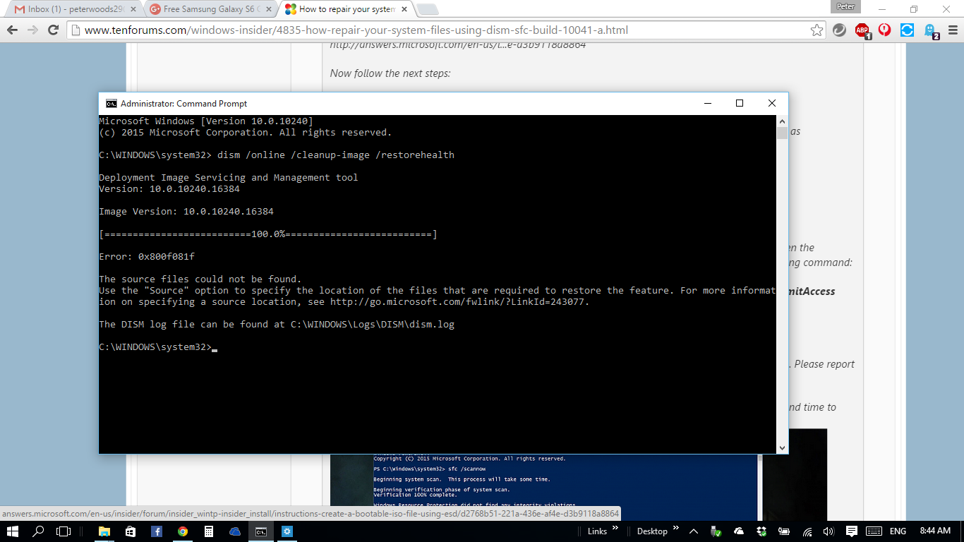

I’m trying to run Dism /Online /Cleanup ……but I’m getting told “the source files could not be found”(screen shot 2)
When I run Dism/………….Scanhealth it says “the component store is repairable” (screenshot 1)
Also no luck with sfc /scannow as it says “could not repair.
I guess I am asking what “the source files could not be found” means. I’m running WIN 10 on a laptop which has been shutting down on its own and last night after shutting down it gave me a blue screen on start up and I got it going again by the Restore Point option. Seems OK now but its still acting strange. I thought a recent reset (refresh)had it good. Thanks Pete.42137-scanhealth42138-restorehealh
DISM says “the source files could not be found”

AskWoody LoungerSeptember 25, 2015 at 5:50 am #1529701The Source is Microsoft. DISM is trying to download a healthy image of the Component Store via Windows Update, which it needs to replace the corrupted files in the Store. Its failing, suggesting that Windows Update service (wuauserv) is not running.
Before typing the DISM command make sure the wuauserv is running by typing this command:net start wuauserv
WSSteve1209
AskWoody LoungerSeptember 25, 2015 at 6:09 am #1529702OK I did the net start wuauserv and it said started, ran the DISM command again and still says source files could not be found. Again, I still don’t understand what command I should use to point to some source file on my WIN 10 system. I read this DISM.exe /Online /Cleanup-Image /RestoreHealth /Source:C:RepairSourceWindows /LimitAccess
Note Replace the C:RepairSourceWindows placeholder with the location of your repair source. For more information about using the DISM tool to repair Windows, referenceWhat is the location of my repair source???

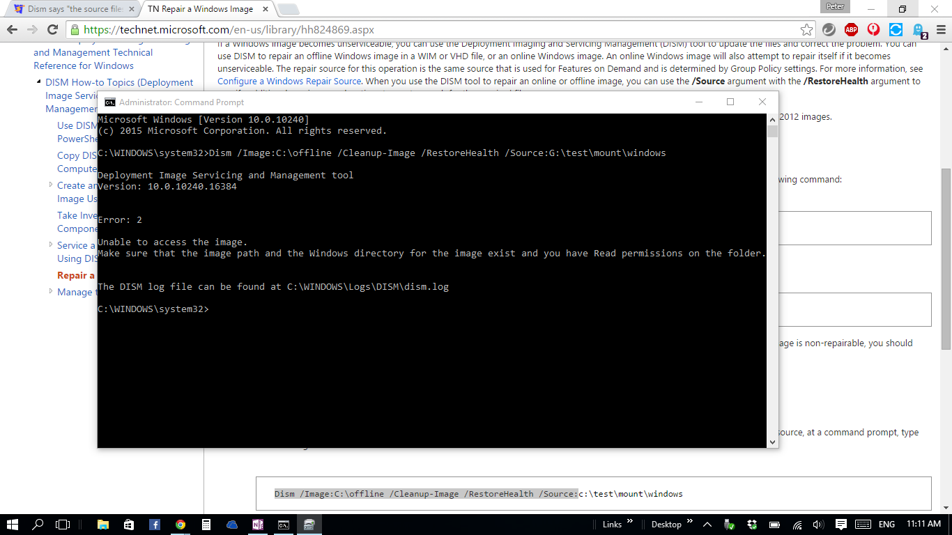

Yes I did change the letter Paul, I ran it with your command “Dism /Online /Cleanup-Image /RestoreHealth /source:WIM:G:SourcesInstall.wim:1 /LimitAccess’ (could not find source….error 0x800f081f)
and also with “Dism /Image:C:offline /Cleanup-Image /RestoreHealth /Source:G:testmountwindows” This gave me (please see screenshot)42158-Unable-to-access
This has me thinking I have not read your post correctly and have not mounted the saved ISO. You have said, Right click on the saved ISO and select “Mount”. This will give you a new drive letter to use with DISM. ” What I done was “Create a download media for another PC” with the download tool (64 bit version). This gave me (next screenshot) on usb G: so I pointed to G:42159-WIN10-on-G-drive
Is this correct. If not how do I mount the new downloaded image OR was I supposed to download it to my C: and mount it there.
