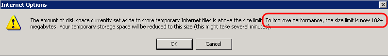

        @ Ted: Re Temporary Internet Files…..are you sure it takes less time to query and download a file off a webserver than to pull it off a hard drive? Perhaps in some cases, but that would imply a very fast internet connection. I also sometimes see improvements in browsing experience by cleaning up the TIF’s, but have yet to adequately explain them.

      Tinto, I guess it’s more the old page gets queried and loaded while the web site is queried, then the new page is loaded. The PC is working finding the correct old page at the same time finding the correct web site to get the new page, rather than just getting the new page from the get go. The other thing is, and perhaps this is just my paranoia, having this old info sitting on my PC is showing where I’ve been, perhaps holding some of my personal info or sign on info, just waiting for someone to break through and grab it. Paranoid, you betcha, but then I have both a sister and sister-in-law than have had their info stolen and have had terrible times solving those problems. I cannot swear this is what happened to them. No one can, so yes I’m paranoid and I wipe everything regularly.
      And yes I do have a fast connection. Time Warner Road Runner, approx 15.5 mb/s download, 1.5 mb/s upload. Pretty fast.
      • #1320412
        Nothing wrong with being safe rather than sorry Ted.
        My understanding was that the Temporary Internet Files are searched for a cached copy of the page and only then if one is not found is the webserver queried. I think that’s how it used to work, but not sure nowadays.
        So, if that’s right, the size and quantity of TIF’s may have a bearing on the time taken to respond to a web request, but I would have expected the indexing to be able to cope with that. Perhaps the indexing isn’t as good as it could be? Your broadband connection certainly is fast, but it is still much slower than reading data of the drive.
        As previously noted, I too have seen improvements by cleaning TIF’s, but the cache is meant to make pages load faster so it’s counter-intuitive that by emptying the cache that the online page loads faster.

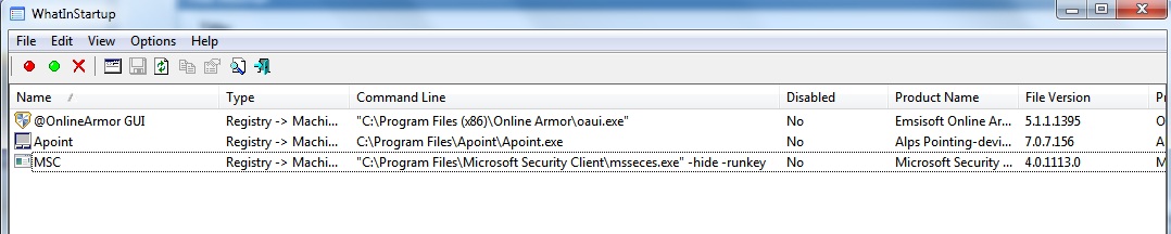

      1. Unnecessary startup items in windows boot.

        A good, fast, well maintained PC does not need to rely on TIF’s to get to where you want to go. Eh?
        Any time lag of downloading a web page should be inconsequential.
          So by implication you are saying that it is slightly faster if the Temporary Internet Files are present. That’s how I would expect it to be, but appears in contradiction to anecdotal observations.

          2: Important on slow CPU, old XP machines:
          Always, always set the Internet Cache size down to 50MB.
          XP by default seems to allocate space for TIFs by some weird percentage of the raw disk capacity. And since HDDs have grown almost exponentially over XPs lifetime we end up with cache sizes that are slowing down the system as to Microsoft’s own admitting; see below. History, history…
          We all have seen this message I assume:
          30133-ScreenShot007
          And in the dialogue to actually set the value MS says:
          30134-ScreenShot008
          Please ask Microsoft, not me, why too large a cache slows down the system. I could speculate a lot but I ain’t good at that.
          Cheers to y’all.

      For those of us who are the “kid” next door (OK I’m using the term pretty loosly here) What’s In Startupis a very easy to use app for stopping those apps that always want to load at Windows startup. Eike I also have Autoruns.
      30132-WhatsInStartup
      • #1320554
        Yes, you are correct. That’s one of the tools I referred to as “… and the like…”.
        But it does not show all the drivers and services as AutoRuns does, does it?
        The previuous was a serious question because I don’t use What’s In Startup regularly ecactly because of this reason.

      Example 2. Many applications come bundled with branding and additional features that are configured to load at startup. This can affect the CPU utilisation and memory utilisation, both of which can have a detrimental effect on performance. Being careful during an installation can often allow one to request not to install additional features. Using msconfig, or 3rd-party apps can get to the root of the issue, buy preventing various startup items from launching. Fine and well, but other than consuming RAM and potentially causing disk swapping, a start up item should not generate a CPU bottleneck after it has loaded.
      As you pointed out, this is mainly a startup issue, which is why the articles on this subject are all about minimizing the startup time. I don’t know about you, but I restart only once every 5-15 days or so, so this seems more relevant to those who restart regularly (like software testers and reviewers).
      Example 3. Browsing the internet may be more responsive if the Temporary Internet Files are rationalised, but the purpose of these files are to provide a local cache to reduce network utilisation, so if there is no local cache, the system must download the files from the web server again. That suggests that a total removal of temporary internet files may actually have a detrimental effect. On the flip side however, if the drive is getting full, removal of these files may improve the disk performance as in Example 1. Also if a corrupt file is located in the cache, removing it would be beneficial to prevent errors.
      I’ve occasionally had to clear the Internet cache in order to get a flash video to play. Other than that, I can’t say that it’s ever posed a performance problem. I still let CCleaner clean out those cached files for me, but only on those rare times that I run it (every 2-3 months?).
      One more thing: Cached and temp files can slow down a backup and use more of the backup medium, but the solution there is to be less broad about what you’re including in your backup.
