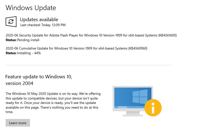

AskWoody_MVPJune 8, 2020 at 9:33 am #2270375I completed the first step, Determining setup issues. As stated and a paraphrase, compatibility files didn’t give a clear direction of what would block an upgrade.
At the current time, I am unwilling to take the next step which is an upgrade attempt.
What was troubling was the final remediation step: find more disk space. In what fashion will waiting until your device is ready for it solve the problem of too little disk space? Does Microsoft intend to “clear a path” through existing files on the system?
My problem may be different from the problem described here, but it strikes me that remediation requires action on the part of the user, not Microsoft. And for that remediation to occur requires clear user-friendly diagnostic documentation.

AskWoody_MVPJune 14, 2020 at 11:12 am #2272261I returned to Determining setup issues, ran the command again, and checked the logs. The most useful log was:
C:\Temp\Logfiles.log\Panther\ScanResult.xmlThis log indicated that two driver packages were blocking migration. Those packages were located and removed, but the message in the log persists with the same two driver packages flagged as blocking migration. All else appears compatible.

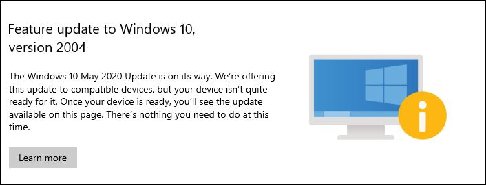

- On viewing Windows update, this message still appears:

AskWoody PlusJune 28, 2020 at 12:49 pm #2276071Yikes, I think I might be now “worthy” all of a sudden, and I didn’t do anything! Today (Jun 28) I now get this different message from last time:
“The Windows 10 May 2020 Update is on its way. Once it’s ready for your device, you’ll see the update available on this page.”
The older message contained the phrase: “…your device isn’t quite ready…“, but not today, now showing the above message instead.
I have read that some 1909 users have been upgraded (magically!) without their permission, i.e. they didn’t actuate the upgrade, it simply did it on its own. So, is there a way to ensure a deferral for this on Win 10 Home?

AskWoody_MVPJune 28, 2020 at 1:02 pm #2276075This registry key may also prevent upgrade for the Windows home version:
AskWoody PlusJune 28, 2020 at 12:52 pm #2276073I think I might be now “worthy” all of a sudden
Nothing has changed, just a new tweaked notice to calm all the millions who got the impression that their PC is broken.
