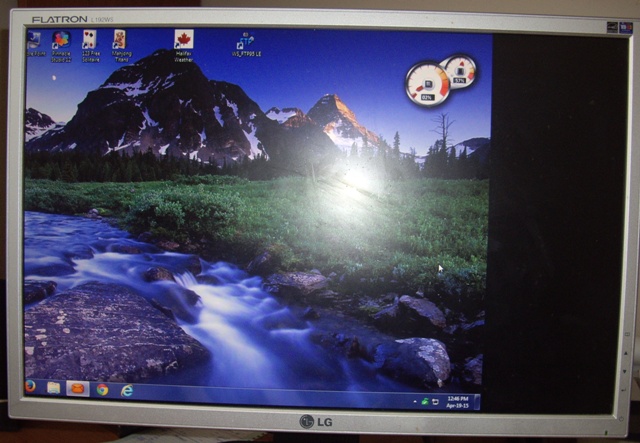

    This has been running fine for a couple of years on the recommended 1440×900 resolution. I haven’t used it for the last 3-4 days and today when I turned it on, the desktop was partially off screen to the left (see first picture.) The monitor’s image positioning function says horizontal and vertical positioning is 50% (centered). I tried moving it 100% to the right but it didn’t have enough adjustment to pull it back fully on screen. I didn’t think that was a solution anyway.
    Everything appears fine during the boot up process and it’s only when the desktop finally appears that it is off screen.

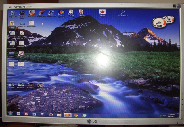

    Changing to any other resolution worked fine – the desktop was in the correct place, although the image was distorted somewhat at most resolutions. I eventually settled at 1280×1024 temporarily (see the second picture) as this was the highest resolution with the least distortion that I can get. So only the 1440×900 shoves the image off screen. I shut down and restarted the computer again – I’ve learned that is often a solution to some problems – but that didn’t make any difference.

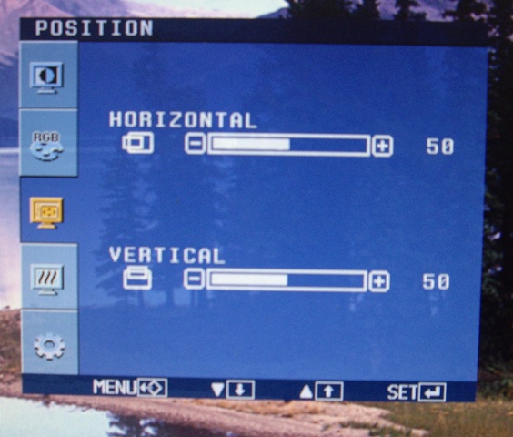

        There is an On Screen Display (it’s showing the default in this picture). I tried as indicated above to move it over to the right but it didn’t have enough adjustment to pull it all back on screen. These are intended for small adjustments.

        The 1440x 900 was the native (recommended) resolution for this monitor which is what it always had been set at until this problem today after which I changed it to 1280×1024 so I could use it. The distortion is only a problem because I’m temporarily (hopefully) using it at this resolution which is not correct for the monitor. If I can get the 1440×900 to properly appear full screen again, the image will be fine.
        40259-Resolution2
