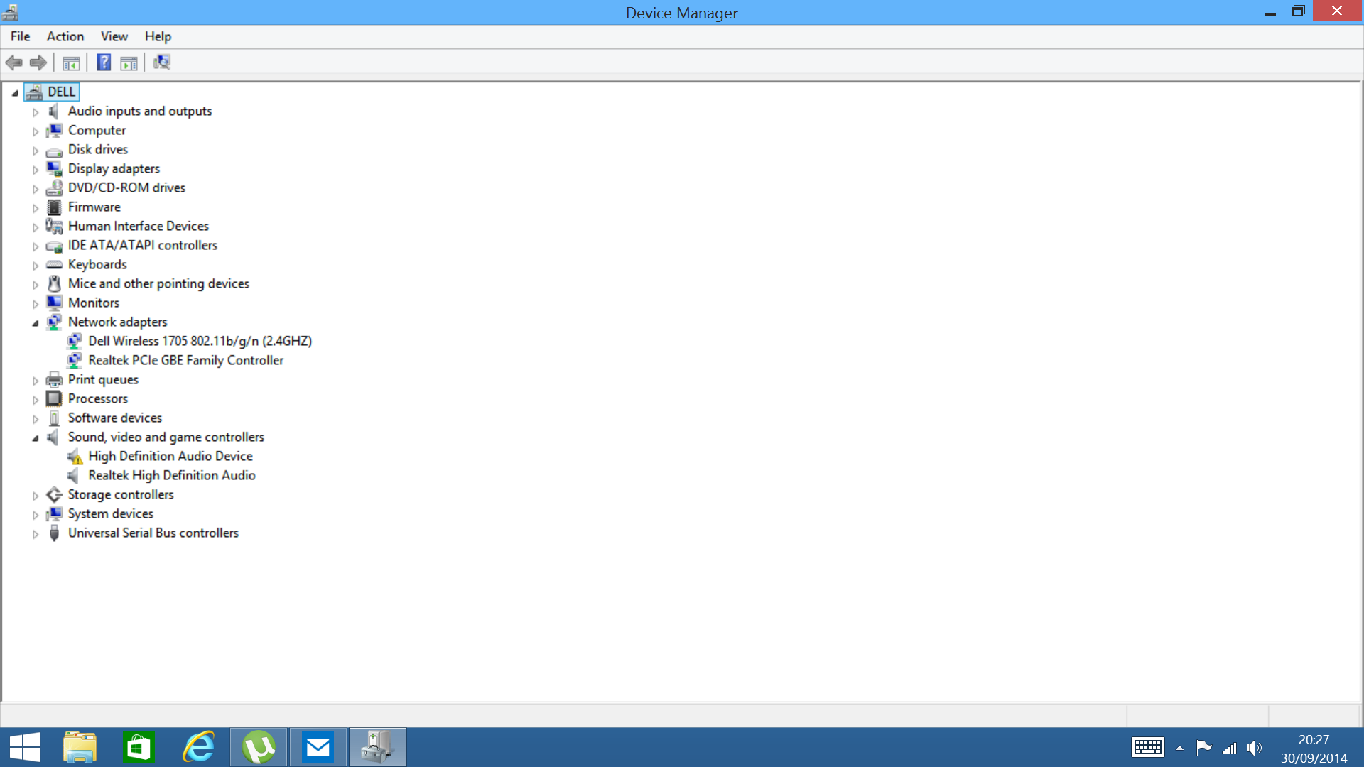

        Where abouts in device manager should I find my Bluetooth device?
        All I can see in there is ”QUALCOMM Atheros Bluetooth bus” Under ”system devices”.
        It states that the driver is up to date and working correctly.

      The Bluetooth devices are listed in Network adapters, so if the QUALCOMM is the only one listed, then that is your Bluetooth device.
      Even though it’s reporting as working, perhaps downloading its driver may wake up Windows so that it’s recognised and activates the Settings – unless that isn’t a Bluetooth device and you aren’t actually using any such as a mouse or keyboard and then there wouldn’t be any settings to change.

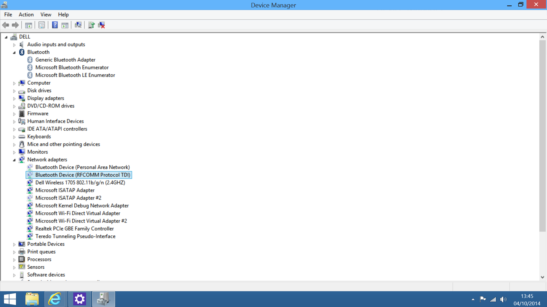

        So , before I downloaded the drivers my blue tooth was showing in PC settings / PC and devices.
        In Device Manager I had a whole section dedicated to Bluetooth.
        In Device Manager / Network Adapters there was also a few Bluetooth devices showing.
        So , I started to install Dells drivers, one being their chipset. After the chipset install all the Bluetooth on my computer was whipped out, all gone.
        Nothing showing anywhere.
        So , I downloaded the rest of the drivers then updated windows, Bluetooth came back!

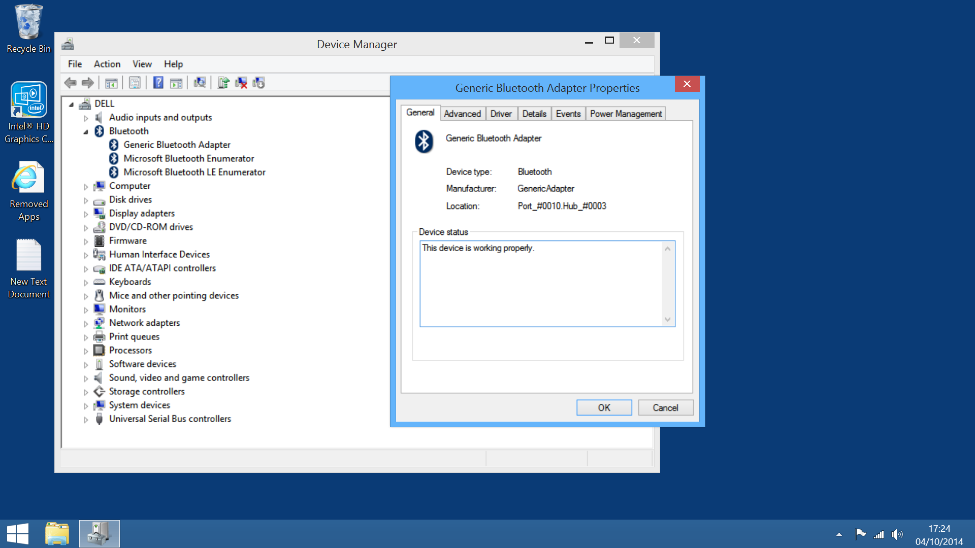

      Last night it all came back, in device manager I had all the Bluetooth drivers showing, in pc settings I also had Bluetooth showing and in the task bar the Bluetooth icon was showing.
      But for some reason it wasn’t discoverable.

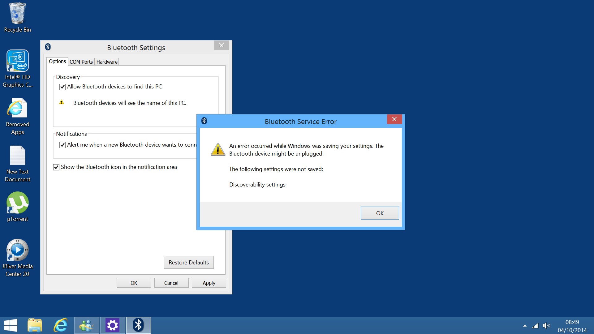

      This morning when I started the computer everything was gone again, no settings, no icon and no drivers.
      In here in pc settings there should be a Bluetooth option in the list on the left should there not?

      The computer finds settings for Bluetooth but when I try to make the computer discoverable I get this error.
      38057-Screenshot-7

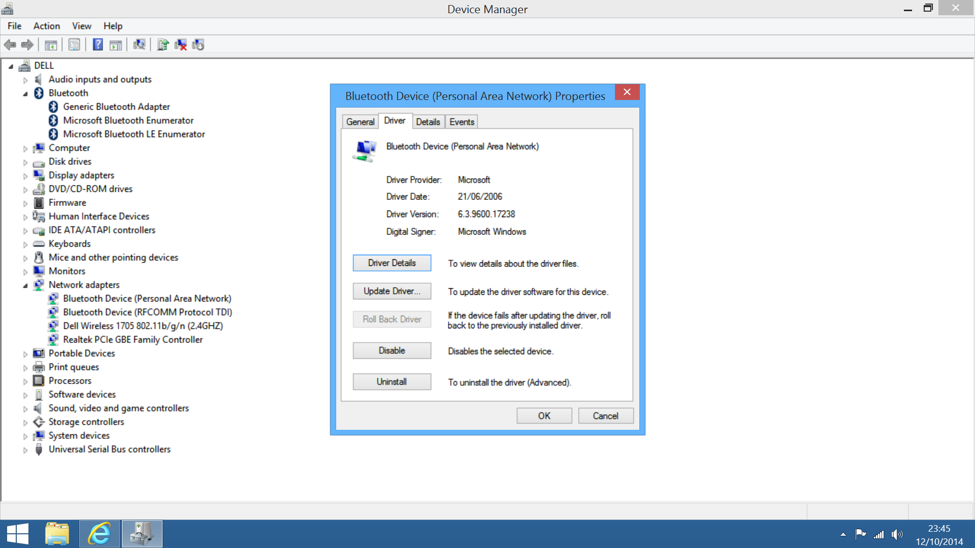

      Last night , towards the top of this list in device manager there was a section specifically for Bluetooth, it held generic Microsoft drivers, four I think from memory, today they have disappeared.
      Also in network adapters there was options for Bluetooth but they have gone also.

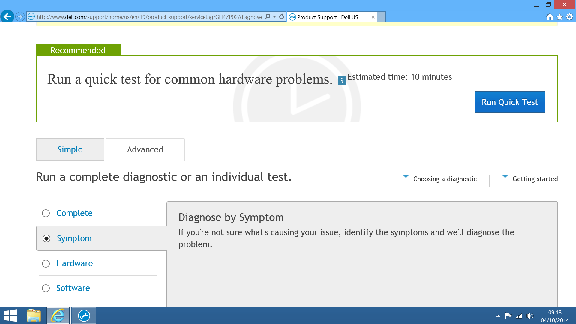

      Another very annoying issue is when I try to use the dell online diagnostics the start button does not work.
      38059-Screenshot-10
      38060-Screenshot-11
      However it will run the quick test which doesn’t include Bluetooth.

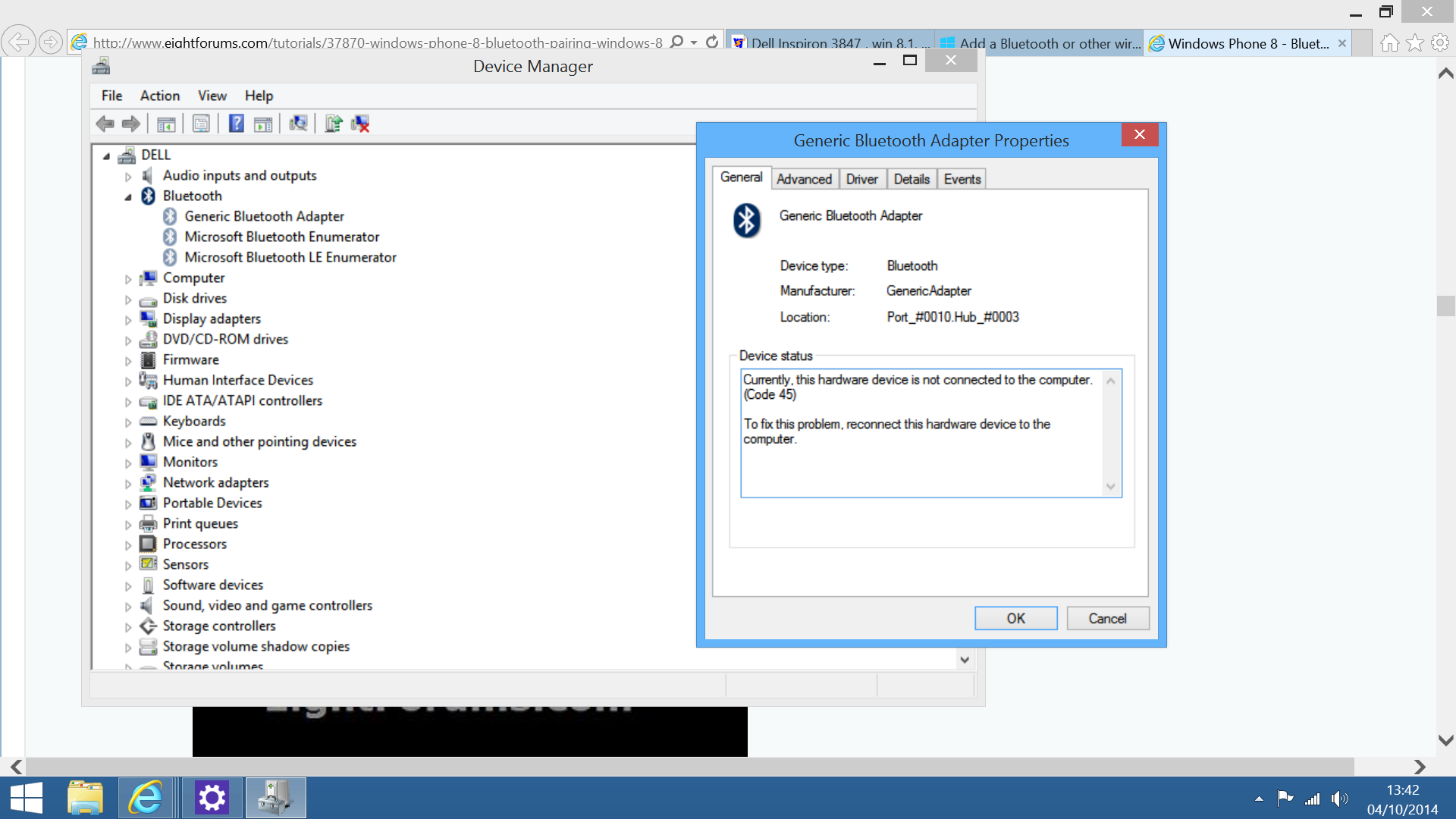

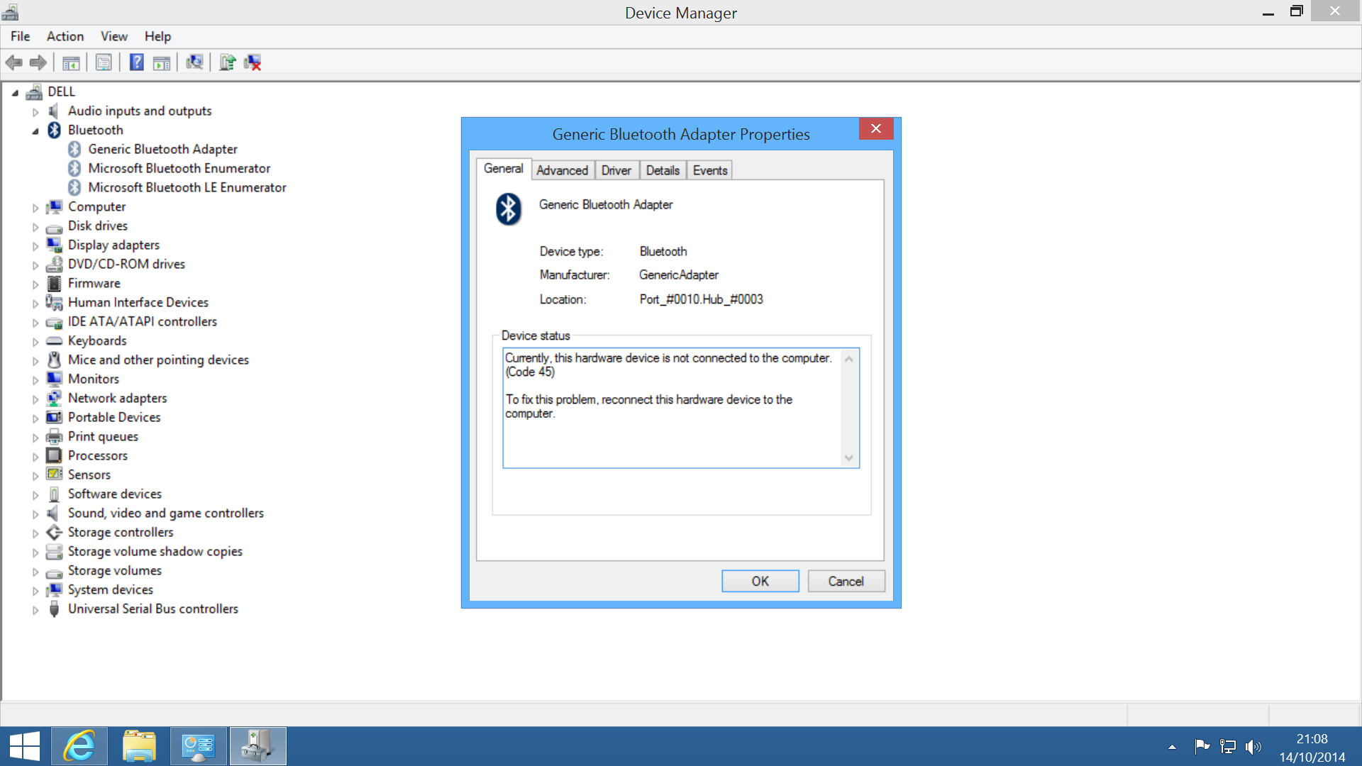

        So I decided to have a play in device manager, I clicked the ”view” then ”show hidden devices” options and I was then able to see Bluetooth , however it says the hardware isn’t connected.
        Whats all this then?

          What’s happened to the QUALCOMM Atheros Bluetooth and did you download the Dell Bluetooth Suite that you said you were going to try ?
          Check Windows Updates to see if there are any Bluetooth drivers it wants to install.
          Was the Bluetooth Support Service Started and Automatic ?
          This is the first time that you’ve mentioned this started to occur after WUs ?
          If you have a restore point to prior those then try that or uninstall Sept’s updates.

              Right then, restored and no Bluetooth, so I downloaded all the windows updates and Bluetooth came back! It still wont connect to anything and isn’t visible, I still don’t have the option to turn it on or off. When I go to Bluetooth it just starts looking for devices, but doesn’t find any.
              Also, I have lost the ability to point my mouse to the top of an app and shut it off via the red square button in the top right, it isn’t there. Now there is a hand that pulls the app down into split screen mode, I also cant shut the pc down without first signing out of my account.
              All the Bluetooth things are now in device manager without looking for hidden devices and are all , or seem to be working correctly.

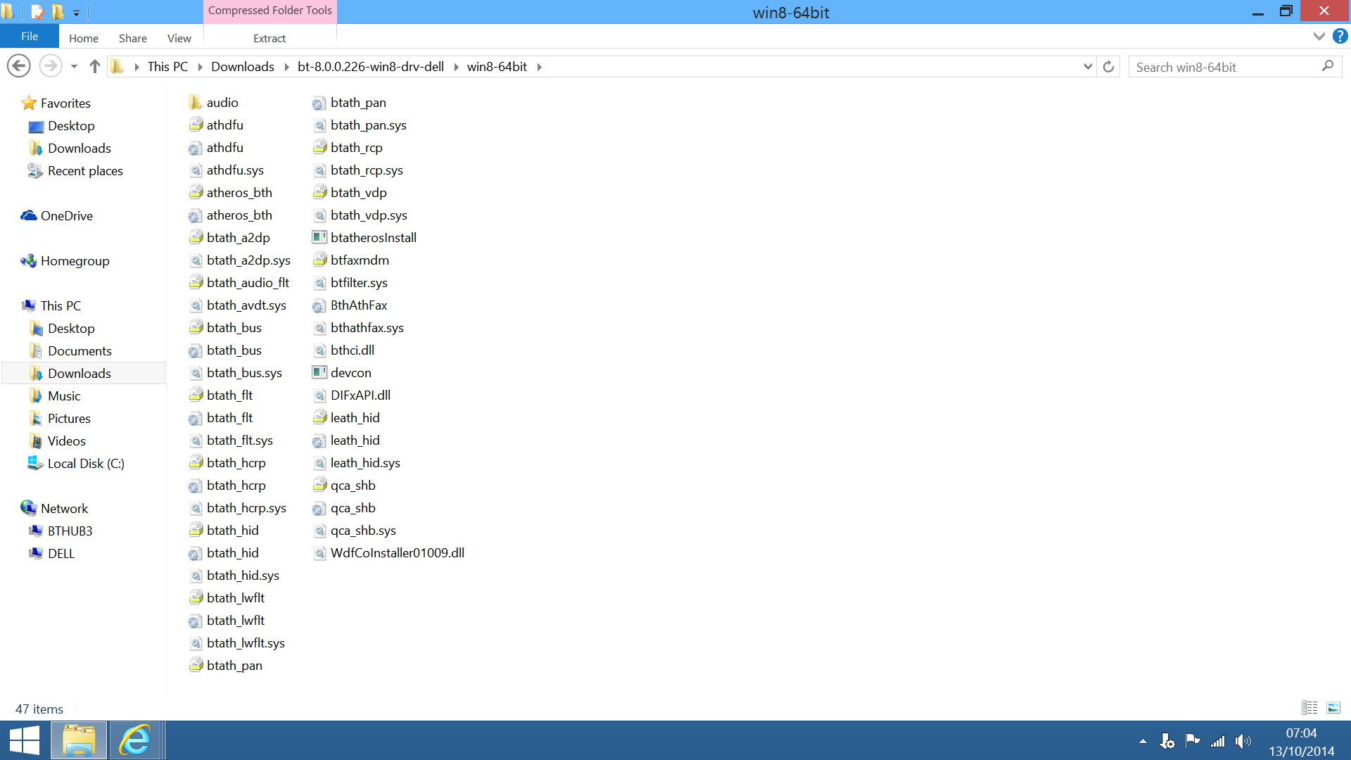

              I think you should install that QUALCOMM Atheros driver again – the generic ones must be Windows own.

        Thanks Bruce, I will try that.
        I’m pretty sure I have already tried that driver though.

        I used Dells drivers for the network card but it looks like anything else to do with Bluetooth is all Microsoft related.
        38140-Screenshot-32
    • #1470748
      Who is the Provider for the RFCOMM ?
      I don’t have Bluetooth on here so I can’t compare what should be in there.
    • #1470749
      It’s alright – I’ve found it http://msdn.microsoft.com/en-us/library/windows.devices.bluetooth.rfcomm.ASPx
      There are quite a few sub links of which I’m none the wiser.
      I see you no longer have that Atheros QUALCOMM driver listed.
      • #1470816
        No that disappeared, I have downloaded it again from the Atheros site. I’m not too sure what a bus controller is or if its in this package that I just downloaded.
        https://www.atheros.cz/getfile.php
        38143-Screenshot-34
        What exactly do I do with these?
        This is what the zip file contained.
        38142-Screenshot-33

          I was looking at that Czech site earlier and while they are WHQL drivers, I noticed it didn’t mention Win 8.1 which could be a problem.
          In the right column of those is a btatherosinstall file but it doesn’t look like a .exe.
          With the Czech drivers when you get a rake of files, you need to use the Update Driver option in Device Manager and tell it the driver is on your computer.

            Thanks for that fella but Dell called last night and we reset the computer back to factory but without the Dell drivers, still no Bluetooth.
            The Dell guy got everything set up and then let me finish it all up. When the system reinstalled I could see all the Bluetooth options in device manager and in PC settings but it could not connect to my Nexus or phone. I just thought this was because of the network driver not being installed. I restarted the PC and it didn’t help, so I shut it down. This morning when I started it up all the Bluetooth options had gone again so restarting doesn’t effect the BT options but shutting down does?
            So tonight another call from Dell and they installed all their drivers, or at least all but one, the network driver. The connection was slow and it would have taken over an hour to download it so I opted to install it myself when it had finished.
            So I’ve just done that and nothing , no BT options anywhere apart from in ”view hidden devices” in device manager. They are greyed out and when I click on them to look at the drivers I get this message,

        After several windows updates and a few restarts they are all back again and operational, I just cant get it to see or connect to anything and vice versa.

              Right then, I gave dell support a call the next day after the engineer had visited and explained that I wanted a new computer. I was told that because it is a refurbished computer all I could have is either a refund or some discs to try and resolve the problem.
              I said lets go with the discs first so he arranged to post them to me. Then he took control of the computer and had a play with it, as a last resort he tried a windows 7 driver but because it was taking so long to download he asked me to install it and email him with the results.
              I installed it and hey presto, Bluetooth works like a charm, or at least I think it does.
              Can anyone tell me if this screen should have any more features to it? It just constantly searches for devices.
              38278-Screenshot-7
              The discs arrived today so I have them if I need to go any further with it.
