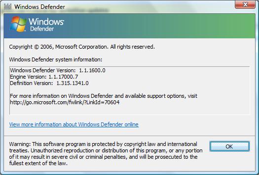

    A couple of years ago, Windows Defender stopped automatically installing new definitions updates in Vista. This was not a big problem because it was still possible to manually download the updates and install them by running the definitions file (mpas-fe.exe) as Administrator; and I managed to keep doing just that until four weeks ago.
    Since the beginning of August, though, this manual method has stopped working. The last definition version is “1.321.534.0 created on 8/3/2020 at 10:49 AM”. Does anybody have insight into what happened this summer (and not before this year) to make this manual installation method stop working?
    Adding to the strangeness is that when I hover the mouse pointer over the mpas-fe.exe file in Windows Explorer, the file information there differs from what I gave above: it has the file version as 1.323.290.0 with a creation date of 7/9/2020 at 11:45 AM.
    Please, no inquiries or comments as to why I’m still running Vista or Windows Defender. I wish to focus on what change did or may have occurred to have the effect described above.

        Good idea, thanks! Here’s what I found. In the last week, there are:
        1. Four instances of Event ID 2001, with Error Code 0x8007007f; and
        2. Four instances of Event ID 2003, with the same error code and matching the times that the above (2001) Event IDs occurred.
        Unfortunately, I couldn’t find much documentation about these events, but from what I read they seem to be related to an inability to update the WD definitions and/or engine.

      It’s most likely due to SHA1 support being discontinued in August for OS’s older than Win7. See this Microsoft article for more info: https://support.microsoft.com/en-us/help/4569557/windows-update-sha-1-based-endpoints-discontinued
      • #2293347
        This may be the key to what’s going on. According to that page, two updates need to be installed in order to continue receiving Windows Updates–KB4474419 and KB4493730. (I had been following the strategy, proposed by some, to use the patches issued for Windows Server 2008 SP2.)
        Last fall, I was able to install KB4493730 but KB4474419 failed to install. Forgot about this; thinking back to it, a BSOD may have been involved. Or maybe it was one of the updates I’ve tried that resulted in a black screen requiring the use of System Restore. Anyway, this must be the exact reason that the updates are now failing.
        The linked Microsoft page says in the introduction that the change was taking effect in late July. My most recent successful Defender update was August 3, and the last check for updates of any kind was August 6. This date is probably when the change actually took place.

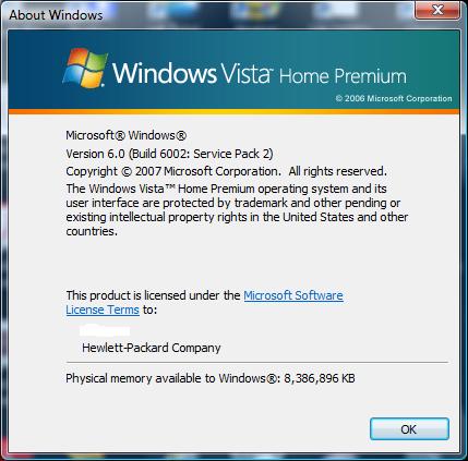

        • I’m running Vista Home Premium SP2 x64. Updates that installed successfully in the past year are KB3217877, KB4519974, KB4517134, and KB4493730. Installations failing in the last year are KB4039648 (uh-oh, there it is), KB4474419 (versions 3 and 4), and KB4499149.
        • I haven’t been able to install any monthly rollups starting with May 2019, KB4499149. They all result in that same completely black screen that I described before. IIRC, the Security Only updates don’t do any better.
        • The KB4039648 that failed is version 2 from June 2018.

      Regarding Windows Defender, according to https://www.microsoft.com/en-us/wdsi/defenderupdates :
      – Starting on Monday October 21, 2019, the Security intelligence update packages will be SHA2 signed.
      – A manually triggered update immediately downloads and applies the latest security intelligence and this process might also address problems with automatic updates.
      To clear the current cache and trigger an update, use a batch script that runs the following commands as an administrator:
      cd %ProgramFiles%\Windows Defender
      MpCmdRun.exe -removedefinitions -dynamicsignatures
      MpCmdRun.exe -SignatureUpdate
      The latest security intelligence update is:
      Version: 1.323.692.0
      Engine Version: 1.1.17400.5
      Platform Version: 4.18.2008.9
      Released: 9/7/2020 8:37:31 AM
      I’m sure you already know all this regarding Windows Defender, but I’m just trying to pin down anything else that might be causing the issue with it. As was mentioned by anonymous above, it seems in all likelihood it’s the lack of the updates installed on your system that are required to support SHA-2 code signing that is the culprit here. However, this does still not explain why your getting a black screen when trying to install updates that should otherwise install just fine such as KB4499180.

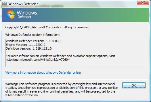

      I ran the Defender script you offered and the definitions version was rolled back to 1.319.1121.0 for 7/9/2020. (It had been 1.321.0.0.) The engine version also regressed, from 1.1.17300.4 to 1.1.17200.2.
      The third line of the script, to update the signatures, didn’t seem to do anything as the Defender UI still lists the 7/9/2020 definitions. A subsequent manual check for updates via the UI led to the familiar “The program can’t check for definition updates” error, with the code 0x80244019.

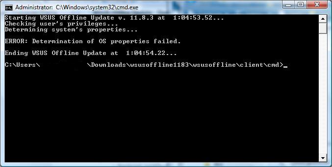

      Before I go too (unnecessarily perhaps) deep into this next suggestion, can you please check under Disk Management and see if you have a System Reserved partition listed? If so, does it happen to be full (at 100%) by any chance?
      The Vista tower’s disk is 1863.02GB in size, advertised as a “2TB” drive. It’s divided into three primary partitions: the C: System Partition (454.71 GB, 29% free), the D: Factory Image (12.61 GB, 23% free), and a storage partition labeled L: (1395.69 GB, 76% free).
      Puzzling and frustrating, ain’t it?  🙂
      Thinking about this, I wonder if the graphics card (an NVIDIA GeForce GT 640)  may have something to do with the booting into black screens. I say this because when this happens, the computer appears to boot normally, until at a certain point there is no more display and eventually the LED on the hard drive stops blinking. However, arguing against this is the fact that when this happens, a simple press of the power button immediately shuts off the PC; whereas typically, if a PC has successfully booted into Windows it will take a 6-second press of the power button to turn it off this way.
      ADDENDUM: I saw your update to your most recent post, regarding KB4499180. When I went to download it, there are actually two files to download, the .MSU patch itself and then also an .EXE file named “pcicompatforserialnumber”. Should this .EXE file be run manually before the .MSU patch, after it, or not at all because it will kick in automatically at some point during the process?

        It’s obvious to me you’re out of luck installing updates that change build 6.0.6002 to 6.0.6003.
        • #2295523
          any revision or version of the KB4474419 update changes the Vista build from 6002 to 6003
    • #2295601
      Thanks for the insight on the the Vista build being unable to change from 6002 to 6003 as the culprit for the black screen behavior, @Volume Z and @EP . This is something that would not have even occurred to me as I have never encountered nor heard of this before. Since I’m by no means an expert on this, nor anything else for that matter, insight like this is invaluable. Do you know what the causes are to make the system behave like this? There is usually no issue with installing KB4474419 on a Vista system, so this has really piqued my curiosity.
      This revelation aside, this still does not address why @Cybertooth cannot update or install any new versions of Windows Defender anti-virus definitions on his system. Obviously, Defender still works on Vista as, as @Alex5723 pointed out above, MS just released an update for Windows Defender on Vista on 08/23/2020. Unfortunately though, this did not apply to @Cybertooth ‘s system but it would have applied presumably to Vista systems still on the 6002 build.
      Further making me scratch my head is the fact the last Cumulative Security Update for IE9 (KB4534251) for Server 2008 from January 2020 (before it went to ESU’s only), installed just fine on this system. It only has a SHA-2 signature but it must not check to see what the build version of the OS is. Since the subsequent IE9 updates failed, it must only check to see if the system is ESU eligible going forward.
      For the sake of my sanity, could you please run the winver command to verify what build of Vista you’re on?

      For reference, here are screenshots of “About Windows Defender” for the Vista tower and Vista laptop:
      Vista-tower-WD
      Vista tower
      Vista-laptop-WD
      Vista laptop
      • This reply was modified 4 years, 7 months ago by Cybertooth.
    • #2297293
      The Windows Defender Versions are the same on both systems (1.1.1600.0), yet the Engine Versions and Definition Versions are different. I wonder if the desktop being on build 6002 and the laptop being on build 6003 has anything to do with this discrepancy? Or, since you’ve been regularly updating the definitions on the desktop up until August 2020, even though it is the build 6002 system, this may be the reason. Do you recall the last time you updated the definitions for the laptop on build 6003?
      Is there a changelog for the Engine Versions anywhere? Based on the above results, it would seem the engine version incompatibility issue must have started prior to it moving to version 1.1.17300.4, but how can we pinpoint when?
      Vista tower (Build 6002) – Engine Version: 1.1.17200.2
      Vista laptop (Build 6003) – Engine Version: 1.1.17000.7

      Tried that tonight. Here’s the result:
      WSUS-installer-Vista-laptop
      Eagle eyes might notice that, in this case, the WSUS Offline installer version 11.8.3 was used; that’s the last one reported to be compatible with Server 2008 according to this MSFN post.
      For good measure, I also tried version 9.2.5 (the same one as for the Vista tower), which is the one recommended in that post for use with Vista. I obtained identical results as in the screenshot above.

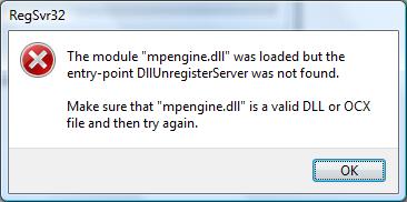

              I navigated to the randomly-named Definitions Updates subfolder and tried to unregister mpengine.dll. This is what happened:
              RegSvr32-error

      Hi fellows
      Im the one with the offi2010 not updating…so i managed to show my WD updated..but just the definitions not the engine dll..
      then steps:
      1. stop wd service
      2. unpack the recent mpas from web
      3. copy the vdm files to the folder where wd store updates (mine: ProgramData>M$>WD). I replace in backup and the other long folder…just in case i backup that old definition folder
      4. restart wd service
      note: after wd restart i didnt see a change..then reboot and voila wd seems updated
      i really dont know if the old engine will properly work with those vdm s,  most likely not in the near future..any way i think it will for few time till m$ patch it
      oppsss I just read regarding registering the new dll…will try some other day..and also to try run the mpsigstub with the new vdms but with old engine..Let u know if succeed
      Regards
      LK

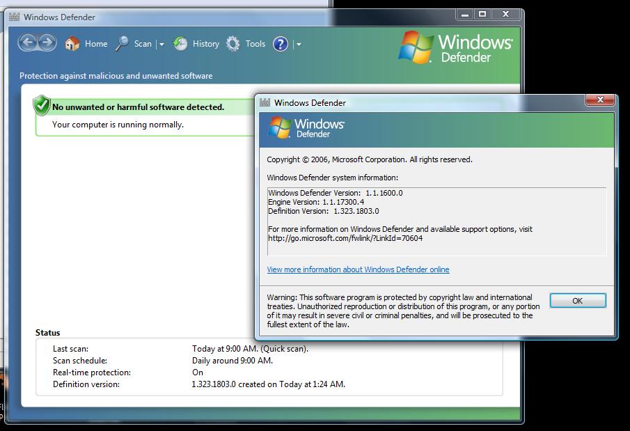

      […]so i managed to show my WD updated..but just the definitions not the engine dll.. then steps: stop wd service unpack the recent mpas from web copy the vdm files to the folder where wd store updates (mine: ProgramData>M$>WD). I replace in backup and the other long folder…just in case i backup that old definition folder restart wd service note: after wd restart i didnt see a change..then reboot and voila wd seems updated
      That worked!!! Thank you!
      WD-up-to-date
      We shall see for how long this method keeps working (maybe until Redmond sees this thread), but for now it looks like we have a solution.  🙂
      For the Vista tower, I did not even need to reboot the machine. Just make sure to place the two new .vdm files (along with the old mpengine.dll) in both the randomly-named subfolder and the Backup folder. If you don’t copy the .vdm files to the Backup subfolder also, WD will use the definitions files that are in the Backup subfolder. (I was briefly back at the August 3 definitions that, early on in this thread, had seemed to disappear in favor of the July 9 definitions, until I put the September 24 defs in both subfolders.)
      This involves a few minutes of work, but at least it can be done.

      Fellows, LK  here (the of2010 guy)…I found a command so just to unpack and run the command from Win+R or from cmd (i did cmd as admin to show a log…where it shows the command and where i picked)
      so then:
      1. unpack latest mpas
      2. where unpacked replace for the engine dll that is ok for you
      3. Run this from Win+r or admin command prompt (might work from powershell..didnt test it) using the unpacked path
      C:\WinDef\mpas-fe\MpSigStub.exe /stub 1.1.16900.5 /payload 1.323.1940.0
      where /stub is the version for the mpsigstub unpacked……. /payload is the version of the definiton update
      then u wont need to stop/start wd service…u will have the event viewer reg in system showing your update and if u run from admin cmd u will have the log in windows>temp>mpsigstub.log
      thats where i got the command …(when i run once the mpas-fe.exe as administrator..then it wrote a log and digging there i found this)
      NOTES
      • the original command was including /stub /payload /program…but program was the path for the mpas-fe.exe…but as i try to use the unpacked i change it  /program for /path.. (unfortunately i didnt run in cmd admin to see errors) and the  WD was updated
      • next command i did was using just /stub /payload…but payload was with another version different from the version of the file…so it run ok (this time with admin cmd) WD was updated. According to the log i guess it didnt take in count the diff version from the command and the file itself for mpasdlta.vdm…weird..tomorrow i will just set the /stub parameter to see if works
      So, fellows some digging have some fun lol
      Hope it helps
      LK

      LK Here….so final command
      Run it better using admin cmd from the path you unpack the latest mpas, remember the /stub is the file version of MpSigStub.exe you are about to run
      You can check the WD result in Event Viewer > Windows logs > System >> search for source Windows Defender
      Also if you run it from System Console = cmd (as administrator), you are able to check the log for MpSigStub in Windows > temp >MpSigStub.log
      Note: Original command parameters from where I dig was
      /stub 1.1.16900.5 /payload 1.323.539.0 /program C:\Users\Franco\Downloads\mpas-fe.exe
      /stub >> version file for MpSigStub.exe
      /payload >> version of mpasdlta.vdm (open with any text program ..i.e.:textedit…to view it at top of file)
      /program >> path for mpas-fe.exe file
      This parameter you can also find in MpSigStub.log when you run mpas-fe.exe as administrator (see post #2299191 for other notes)
      Comment: dont know if M$ will fix for w2k8, as also it has reach its EOL..might be solved to whom have paid for EOL extension
      Enjoy
      Regards
      LK

      Well I just updated successfully the WD running the mpas-fe.exe directly  (my WD had definition up to Sept28th), so abbodi86 was right. M$ might fix it…just in case I will backup old engine dll
      Laters
      LK
      • #2301355
        Is your engine version 1.1.17500.4 now?
      • #2301950
        LK, that’s interesting. My two Vista machines that “starred” in this thread are not updating WD automatically. I just tried manual updates, and both failed. FWIW, the Vista laptop failed with error 0x8024419j while the Vista tower failed with error 0x80072efd. Both are still using definition version 1.323.1803.0 from September 24, under engine version 1.1.17300.4.
        I then tried to manually install mpas-fe.exe… and it worked on both computers!! (Curiously, Norton 360 flagged it as unknown and offered to kill it, something it had never done before with mpas-fe.exe. But–even stranger–it offered to do this only on the tower, not on the laptop which has the same Norton program installed.) They are now on engine version 1.1.17500.4 and definitions 1.325.247.0 from October 5.
        Thanks for staying on top of this issue and continuing to try updating.

        Just an FYI that the release notes for the new Windows Defender engine v1.1.17500.4 (released 01-Oct-2020) and other monthly platform and engine versions are posted <here> on the Microsoft Docs site.
        The release notes for the previous v1.1.17400.5 engine state there were “No known issues“, even though user BenK-9145 posted in the Microsoft Docs thread SCEP for Windows Server 2008 Standard No Longer Updating (i.e., the thread abbodi86 mentioned in reply # 2299355) that Microsoft Support privately acknowledged that engine v1.1.17400.5 was the cause of the failed virus definition updates on Win Server 2008 machines and that an official engine fix would be coming “at the beginning of October“.   It’s unfortunate that  Microsoft isn’t more forthcoming with known issues in their public documentation.

      Both my Vista tower and Vista laptop now have Definition version 1.327.128.0 running on Engine version 1.1.17600.5.
      While my head is still spinning from all discussion regarding the problems you were having when attempting to move your Vista desktop to Build 6003 (while your Vista laptop had no such issues), and while I am also not trying to stir it all up again, I am both happy to hear this and completely baffled you were able to install the new WD Definitions and Engine to both systems because as pointed out above:
      mpas-fe.exe files released since 21-Oct-2019 are now digitally signed with SHA-2 so this offline installer cannot be used to update Windows Defender definitions unless the user has installed the required Win Server 2008 updates to add SHA-2 support to their Vista SP2 device.
      Since the desktop is missing KB4474419 but the laptop isn’t, how is this possible?

      @7ProSP1, of the three patches you listed, the Vista tower has KB4090450 and KB4056564 installed.
      And there you have it:
      KB4090450 and KB4056564 were both released on March 13, 2018 and added SHA-2 support well before KB4474419 was released on September 23, 2019.
      Much appreciated, @Cybertooth and thanks again to @lmacri, @abbodi86 and @volume-z  for their further clarification.
