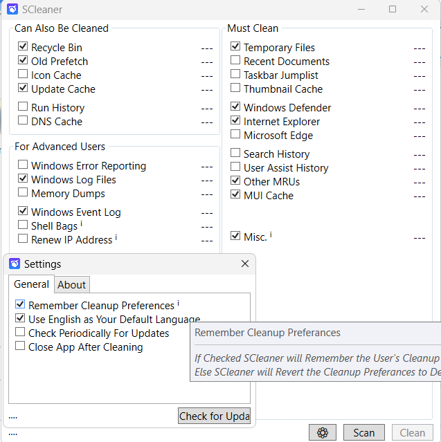

Every time I start or restart the computer, it changes my default browser to Microsoft Edge when my chosen default is Chrome. This started happening after I downloaded SCleaner and ran it. This may be only correlation not causation, but this is only happening on one computer out of the four that I own. How do I make my default browser stick?

AskWoody MVPNovember 27, 2024 at 6:03 pm #2720843If neither solution worked, then perhaps you’re being affected by a very behind-the-scenes change made by SCleaner. Also, keep in mind the following in @satrow ‘s post:
SCleaner on all machines still, you can open it and it should show the Options used last time…compare them with the ‘buggy’ W11 PC to check any differences.
In other words, check the SCleaner setup options on the machine having problems with the SCleaner settings on a machine that’s not having problems and see if there are any differences (if you haven’t already).

AskWoody PlusNovember 27, 2024 at 8:21 pm #2720871SCleaner is installed on one computer only. I usually install new software on one to test before installing on the other three. Now I won’t do that until I find out what caused the problem. It may not have been SCleaner. Thanks for your help.
