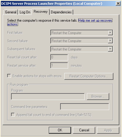

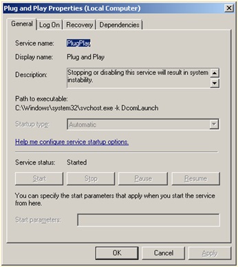

      In many of the posts where this is discussed, there are references to making sure that DCOM is enabled to start, and other such things. When I check my Win7 systems, DCOM properties can not be set in any way, shape, or form (setup type is grayed out).
      41962-DCOM_PlugPlayProperties
      Below, notice the lack of Start/Stop/Restart:
      41963-DCOM_Properties2
      Below, notice that all recovery options are grayed out (only restart the computer is allowed):
      41964-DCOM_Properties3
      The following is from the help file link:
      “To perform this procedure, you must be a member of the Account Operators group, the Domain Admins group, the Enterprise Admins group, or you must have been delegated the appropriate authority. As a security best practice, consider using Run as to perform this procedure.”
      It would seem prudent to set the first recovery to simple restart DCOM, but since it lacks those options, and without the above noted authorties, that can’t be done.
      For PlugAndPlay & Power services, the failure option can be configured. DCOM is the critical component and little can be done if it fails.

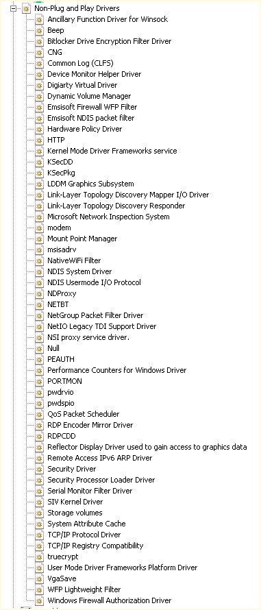

      I have the following update from my two Windows 7 systems. This is the list of items that depend on DCOM running.
      Win7 production system DCOM dependents (functions dependent on DCOM running)
      —At the top level (1 entry)
      +Remote Procedure Call (RPC)
      —At the levels below RPC
      Acronis Scheduler2 Service
      Acronis Sync Agent Service
      ActiveX Installer (AxInstSV)
      Application Identity
      Application Information
      Background Intelligent Transfer Service
      Base Filtering Engine
      Bluetooth Support Service
      BrYNSvc
      Certificate Propagation
      CNG Key Isolation
      COM+ Event System
      COM+ System Application
      Credential Manager

      — Clean install Windows 7 system has above but also this:
      +Base Filtering Engine
      IKE and AuthIP IPsec Keying Modules
      Internet Connection Sharing (ICS)
      IPSec Policy Agent
      +Microsoft Network Inspection System
      Mocrosoft Network Inspection
      Routing and Remote Access
      Windows Firewall
      Finally, some kind of difference to investigate.

        The Microsoft reference is incorrect in that you cannot stop or disable DCOM. The properties dialog shows those options disabled. But, go ahead and try it (I have Home Premium, so higher level versions may allow DCOM to be stopped or disabled; disable at your own risk…when you reboot, it might not come back up).
        Given that long list of dependencies perhaps it is wise to pass on that! 😉

    • #1530178
      DCOM is so embedded in the system, there are so many things that can’t be done when it fails. For example, turning TCP/IPv6 back on requires a successful boot where DCOM does NOT fail.
      Hostednetwork disallow made no difference. However, the list of non-Plug and Play drivers is interesting:

    • #1530181
      Yes, you do get quite a lot of items in the Non-Plug and Play section and some of those are Dependencies to the main services.
      While the good news from what I can read (don’t have magnifying glass :)) is that there are no yellow alerts.

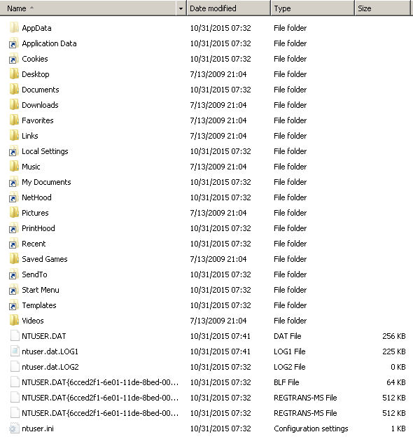

      Additional:
      When DCOM failes, if you choose to bypass the automatic restart, then the system is also unable to find your userid (DCOM fails, how can it find your userid?) As a result, temporary userid directories show up in the c:users folder. They are labeled TEMP.[computer-name], TEMP.[computer-name].000, etc. Mine is up to 007 at this point. The contents of each directory looks like the nomal contents of a valid userid directory:
      42453-TEMP_computer-name_007
      What I have been doing lately is to simply re-boot immediately after the DCOM failure until the computer boots successfully. This take anywhere from 5 to 10 attempts (each attempts is about 3 minutes of time wasted).
