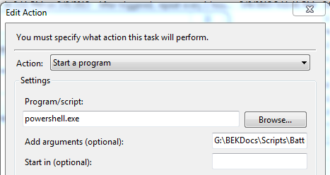

Next create a scheduled task that will fire every hour (or time interval of your choice ).
33333-TSAction
Note: You need to pass to the program {after the program name in the Action pane of the scheduled task } the mWh ( milla Watt Hours ) FULL capacity of your battery! I used the Battery Meter program to find this value. So the optional parameters would look like d:pathBatteryStatus.ps1 7730Done!

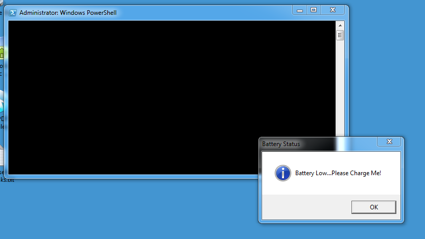

When the task fires you will get the following message if the battery is below the threshold and you are NOT plugged in.
33332-LowBatteryMsg
See the messy part it shows a command window along with the message and that window will flash even if the message doesn’t display. When you click OK both windows close.The code as written checks for low battery since that was the easiest to check as I was writing the code. You can easily change the test from -le to -ge and also the percentage that follows to your desired threshold levels. You could also make the code check for both low & high charge conditions and print the appropriate message. BTW don’t forget to change the $Message value as appropriate.

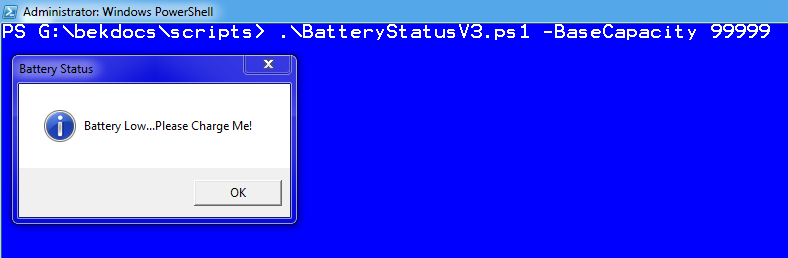

AskWoody_MVPSeptember 2, 2013 at 11:05 am #1409843Asifbaig,
Ok, here goes with a “stupid” question. 😆 You are running this on a machine that has a battery?
I tried it on my desktop and got errors although not the same as yours:
[noparse]
Get-WmiObject : Invalid class “BatteryStatus”
At G:bekdocsscriptsBatteryStatusV3.ps1:19 char:2
+ Get-WmiObject -class BatteryStatus -ComputerName LocalHost -NameSpace rootWMI
+ CategoryInfo : InvalidType: (:) [Get-WmiObject], ManagementException
+ FullyQualifiedErrorId : GetWMIManagementException,Microsoft.PowerShell.Commands.GetWmiObjectCommand
[/noparse]
But it ran just fine on my laptop.
34840-BatteryStatus
HTH :cheers:WSasifbaig
AskWoody LoungerSeptember 3, 2013 at 4:41 pm #1410147Yeah, I ran it on my laptop with the battery still attached to it (either that or my desktop became self-aware, disguised itself and is planning to kill me 😉 ).
