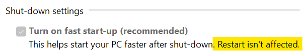

          In Control Panel\Power Options\Choose what the Power Button does, turn off Fast Startup. Then restart the PC.

            Restart is never affected by Fast Startup:
            Restart-isnt-affected
