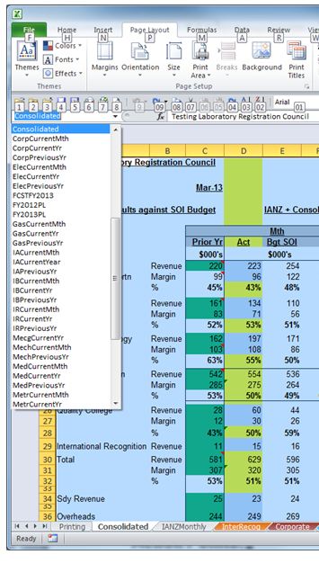

AskWoody LoungerDecember 15, 2013 at 5:45 pm #1429218Maud hi
I think I have got to the bottom of my problem.
I asked if I could copy print areas when I shoulkd have asked “Can I copy named ranges” instead.I have attached a screen dump of a range named “Consolidated” and part of the highlighted area.
35784-printaresMaud

AskWoody_MVPDecember 15, 2013 at 7:21 pm #1429241Bonriki,
If you want to copy named ranges then use the following code:
Code:Public Sub CopyRanges() For Each x In ActiveWorkbook.Names Workbooks(“Target1.xlsx”).Names.Add Name:=x.Name, RefersTo:=x.Value Next x End Sub
Note that all the ranges will appear in the target Name Manager, however, they will only apply to the sheets if the sheet name is the same
