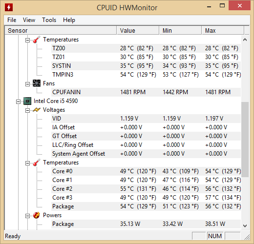

AskWoody MVPMarch 14, 2015 at 4:09 am #1495122All you need is a SATA hard disk, all cables already exist in your PC.
If the fan is unwell you will see high CPU temperatures. You can check this with HWMonitor – the free edition.
If your PC is dusty you can clean it with a vacuum cleaner on low power.cheers, Paul

WStiger4
AskWoody LoungerMarch 16, 2015 at 5:27 am #1495506Installed it. Didn’t see much of anything on it. Couldn’t figure it out. So I uninstalled it.
