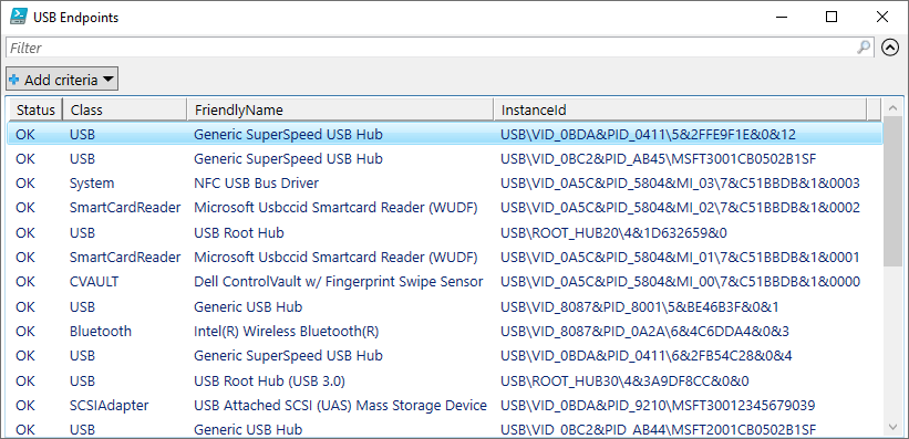

      Or use PowerShell in an elevated console to query your device’s USB endpoints. Something like the following will probably do the job:
      Get-PnpDevice -PresentOnly | Where-Object { $_.InstanceId -match ‘^USB’ } | Out-GridView -Title “USB Endpoints”
      It should give you a grid output similar to this:
      usb_endpoint_query
      Maybe the Status column (which you can sort on, by clicking on the column header itself) will show the non-responding USB device.
      (I wrote Maybe because the Microsoft documentation does not make it clear whether instantiation includes presentation at the (File) Explorer level, just connection at a hardware level. They’re different states, IMO.)

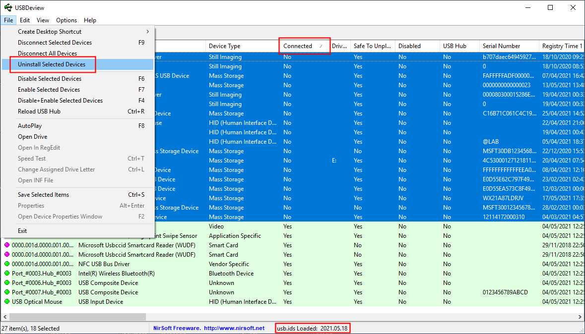

      The (temporary) cure (except for hardware failure) is to use Nir Sofer’s USBDeview (using the right-click Run as administrator option), select ALL devices except currently connected mouse/keyboard entries then uninstall the lot:
      usbdeview_uninstall_selected_devices
      This clears the Windows’ Registry Editor‘s history of previous USB connections. (They come back the moment you reconnect a USB device.)
