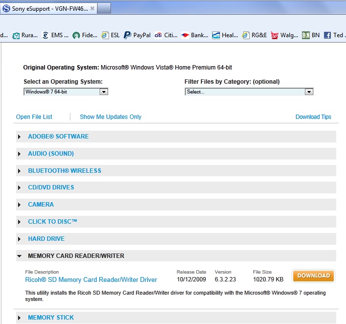

AskWoody LoungerNovember 10, 2011 at 6:47 pm #1306255In my situation, very similar, after installing Win 7, my sc card reader was not seen after the reboot. I went to my PC’s manufacturer’s site (Sony Vaio) and found drivers for the SD Card reader among others. Downloaded and instlled the driver, solved my problem. Perhaps this would work for you as well. Do not go to device manager to update the driver, go directly to the manufacturer’s site.
This is what the Sony site looks like, might be worth a try for your manufacturer as well:

AskWoody LoungerNovember 12, 2011 at 5:51 am #1306430Hi Ted,
I searched the HP site high and low. They don’t seem to have downloads for card reader drivers. They want you to download the “Driver Detective” for $29.95 for one year, after that the driver download will be free. I ran the diagnostic tool which kept urging me to insert the picture card and finally came up with “no media inserted.” So I’m thinking I’m probably better off buying a card reader which I can plug in. It just irks me that for no reason it just failed.
But I thank you for trying to help. It is very much appreciated. -
